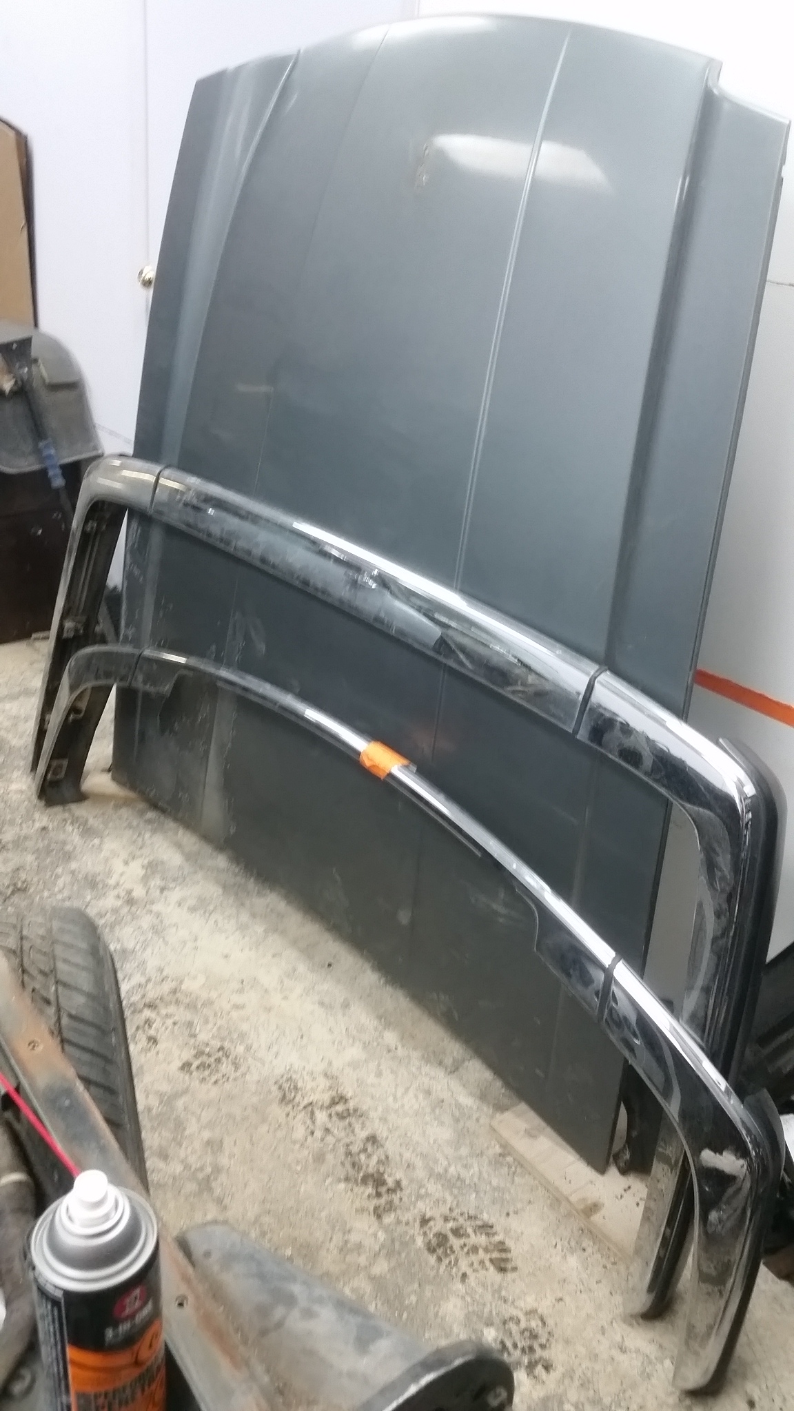

great info guys. being my first project i'm sure there are going to be a learning curve. having this car as a daily drive as well i am going to have to have the cats on, just to keep it clean but taking everything else out and maybe some small mufflers to not **** the neighbors off too much. i plan to make carbon fiber hood, trunk lid, fenders, race seats and remove the sunroof and replace it with a carbon panel to fit and maybe the dash if i get inclined enough. i looked at the dual quad looks great but looks like a pain as well. then i'd have to buy 2 efi conversion kits and rig all that crap up. trying to simplify the whole mechanical operation of this car. i'll have to keep my eye out for a tko 600 and a bell housing and pedals and figure out what wheels and tires to redo the rear end with better gears. planning on 16" rims. 8" in the front, 9" in the rear

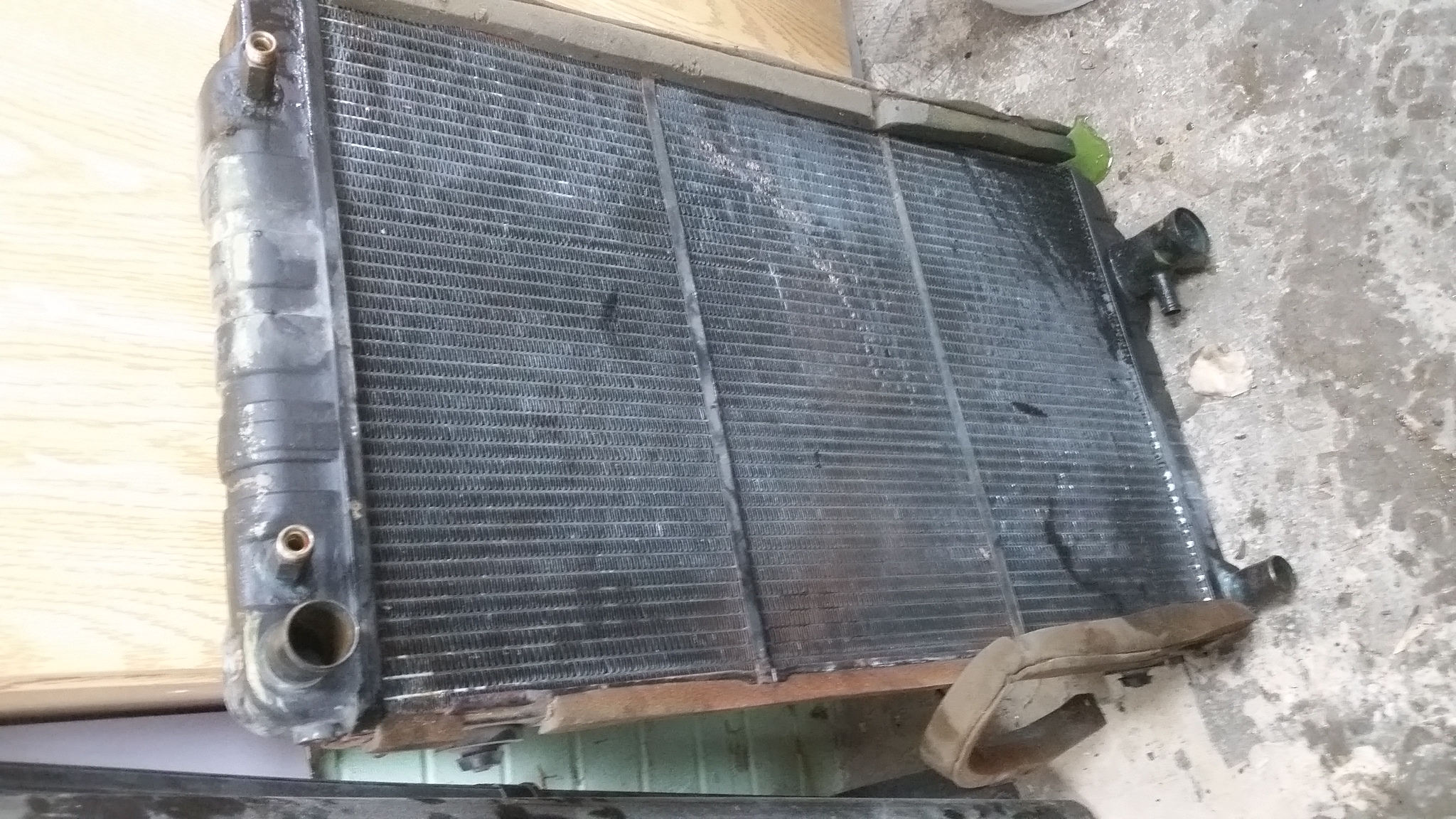

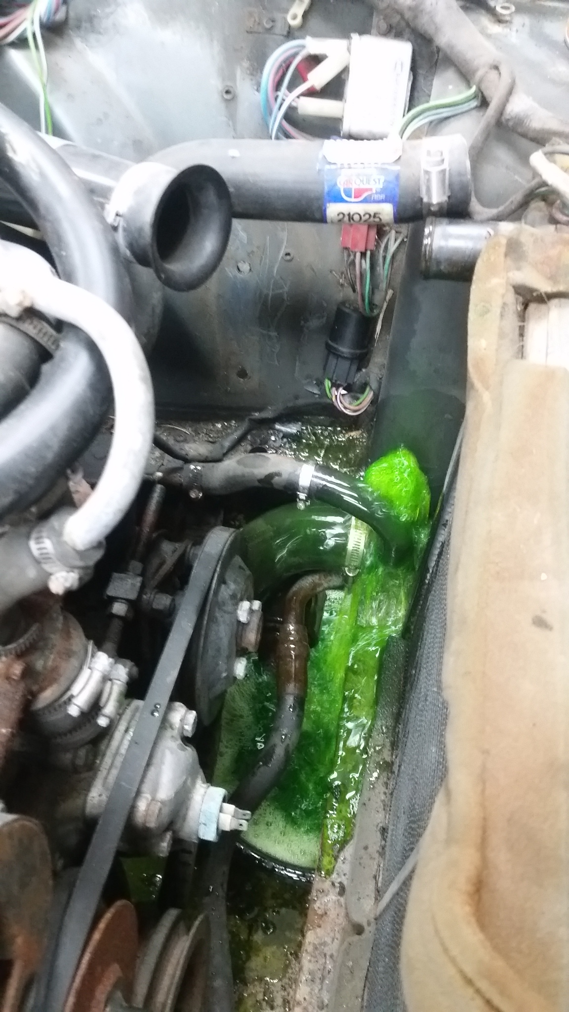

finally got the rad/fan/housing out. man could they put any more antifreeze in this engine? also, discovered a nice drain on the elbow and enjoyed a antifreeze fountain. needless to say my floor is really clean now. the body parts about to be prepped for molding
