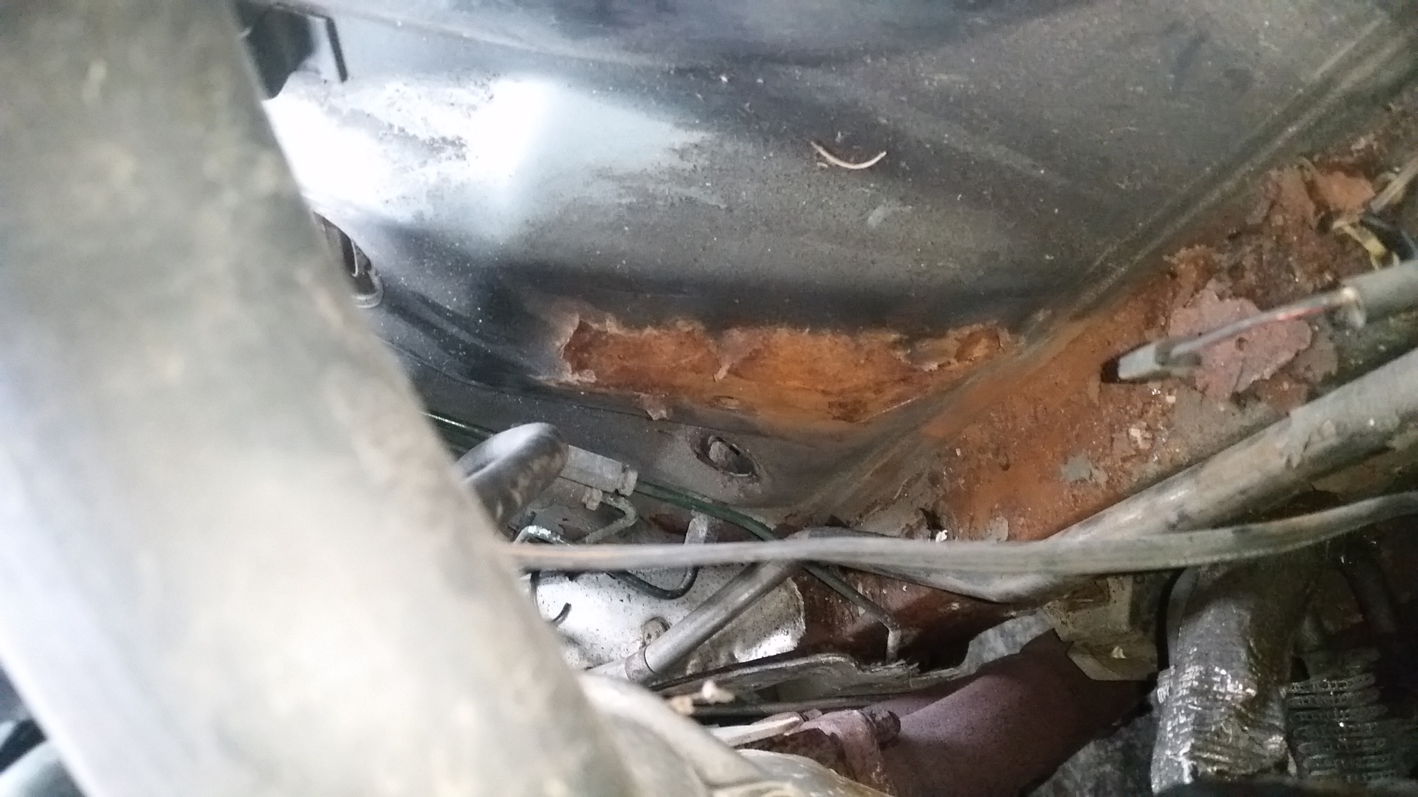

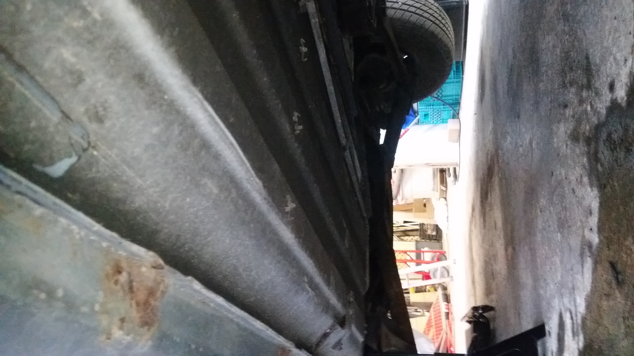

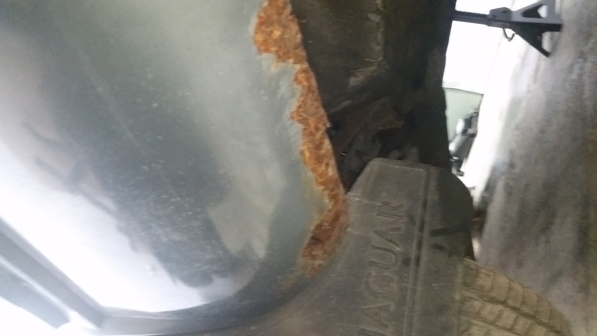

from what i can see under the car and around i have these problem area:
the trunk parts taht cover the mufflers, completely gone half way down. the drain for the sun roof and trunk lip were clogged to the point wher eit looked like a tube with a rust plug in it. so those will be remade in fiber glass and replace.
the right front shock tower. just where the tower gets the second layer of metal is rusted out. i'm going to cut and weld a new panel over it when i get the engine out. the passenger side if perfect.
driver side where in front of the door hinges. theres a hole that i can see in and i still see paint. once i cut the rust our we'll see what i'm dealing with but from what i can see, it looks just like surface rust.
here are soem attached pics. the under side and rear suspension are nice and undercoated with not signs of rust of rust blisters

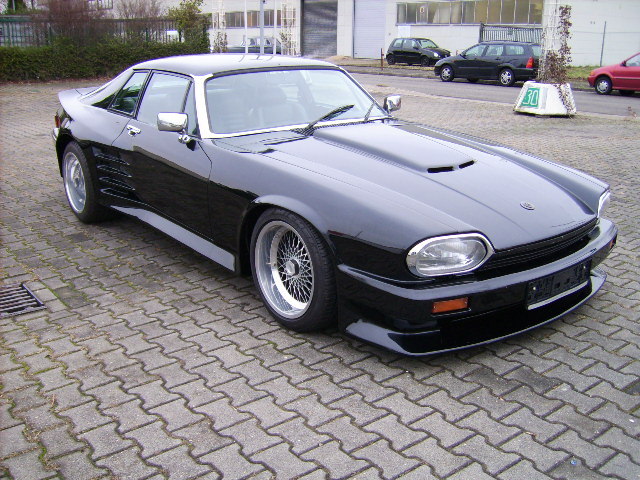

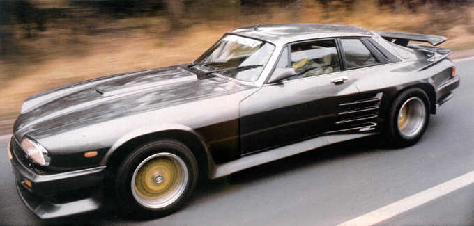

wow, didnt even think about un-installing from the bottom, just always assumed that the top was the way. also just got off the phone from the owner of THE group 44 racing jag. turns out its located about 30 mins from my place. i might go check it out. did a search fior wide body kits, to see what was/is available. no, he wont let me use the mold either. i think when the time comes i might might might consider something along these lines. minus the testarossa fins and the part that come onto the door. maybe put a vent to cool the rear breaks or something. maybe fender flares?. pro and cons of a wide body?
Attached Thumbnails New Jag owner - have some plans up my sleeve-jaguar-xjs-koenig-7.jpg   New Jag owner - have some plans up my sleeve-koenig_xjs3_6comp_autochrome_mai85_p1a.jpg
