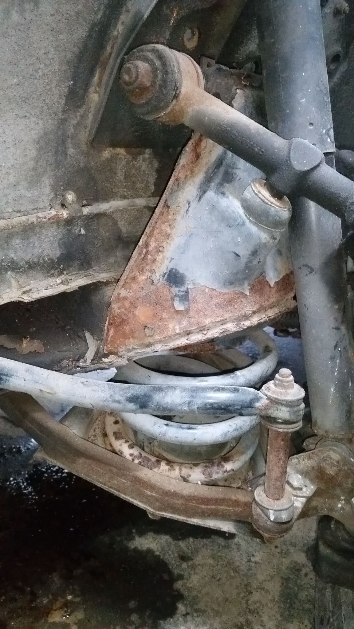

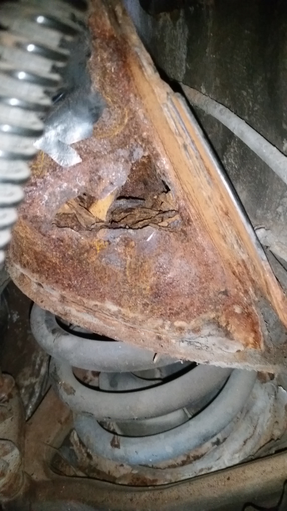

here are some rust issues i have found on the frame. the rest of the car is really good, rust wise just the trunk has the 2 pockets on either side that cover the mufflers rusted out but i'll get to that later. my concern is the rust here on the front suspension. from what i can see and feel the tops of the spring towers i think is pretty bad. once i get the front suspension off i'm sure it'll be worse. the rest of the suspensions looks and feels pretty good just surface rust with no holes. is this repairable if i sand blast it all and grind all the rust off of it and weld new pieces to fill?
Attached Thumbnails New Jag owner - have some plans up my sleeve-20160120_103447.jpg   New Jag owner - have some plans up my sleeve-20160120_103943.jpg   New Jag owner - have some plans up my sleeve-20160120_103610.jpg   New Jag owner - have some plans up my sleeve-20160120_103346.jpg
if you have that much rust on a Jaguar, you most likely have alot more than you expect, has happened many times with jags!
thats why i was given 3 jags, mechanicly reasonable condition, not a lot of money to fix, 2 V12s and a 6, 70s and 80s models!
but the body rust and paint work was expensive( i dont like doing things 1/2 assed).
they are a unibody car, lot of nooks and crannies that you cannot see(and some you never will) unless you open up the main body rails/pockets and look inside them! you cant do that unless car is stripped bare.
for my 78 XJS ,was stripped to the bare bones shell nothing left on the shell/platform and put on a rollover rig for 360* rotation, media blasted, the only way to do a proper rust removl and replace all steel sheet metal pieces), welding upside down is hit and miss at best(my opinion).
then a complete spray with GOOD rust proofing Epoxy ,2 coats!
and for race purposes you should do a lot of reinforcing of the body, Jags,especially old flexy-flyers, that have been cobbled together!
anyway after reading thru your posts, i wouldnt at this stage worry much about engine/drivetrain, get a solid platform and suspension under it, that should give you some time to think about what will be best to power it!
