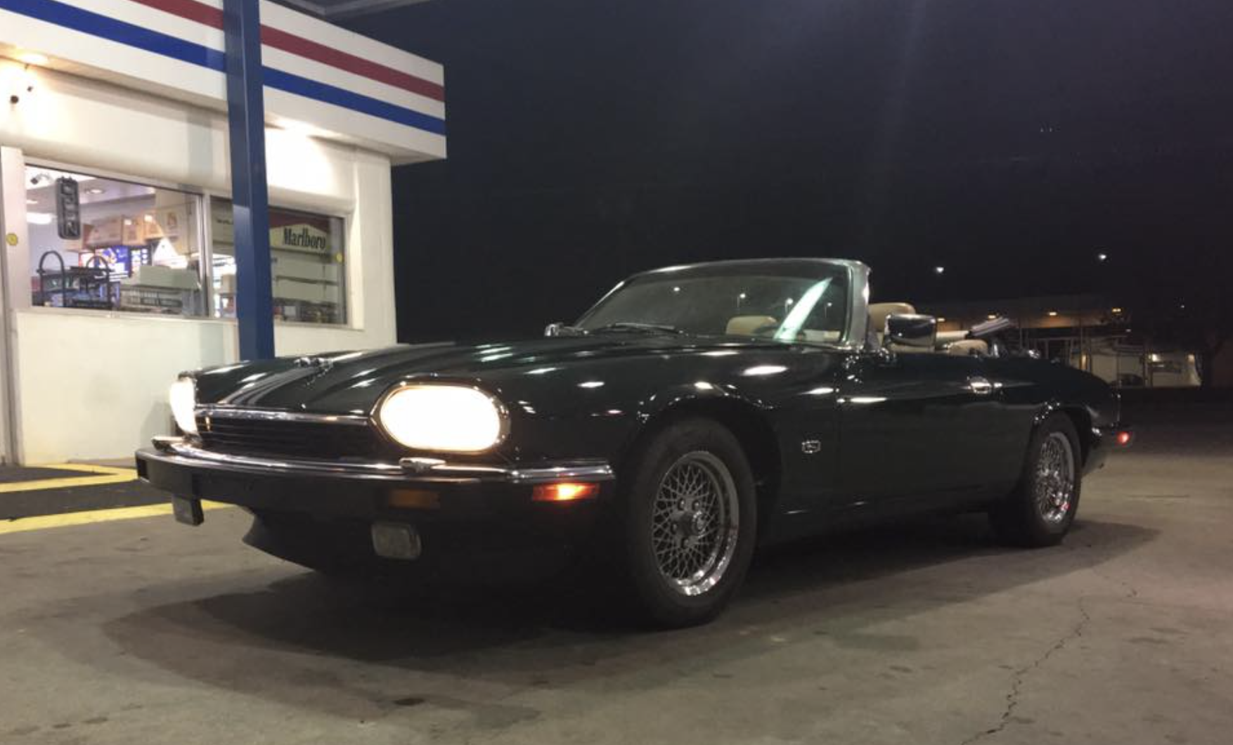

Thorsen, your solution worked like a charm! But furthermore, is there any thing I can do to clean these relays, Some of them don't look too good, or would it just be better to replace them? Here she is by the way:
Thanks.
-Hubauer
