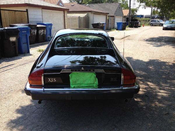

Oh I forgot to add pics of the car. I need to some better ones when I get it out of the garage....
Attached Thumbnails New owner research makes me wonder WHY!-jag4.jpg   New owner research makes me wonder WHY!-jag5.jpg   New owner research makes me wonder WHY!-jag6.jpg

Great looking Jag!
Welcome.

Why? Every time you park that beauty and walk away, then feel compelled to turn around and let your gaze linger on it a moment... you'll remember why
