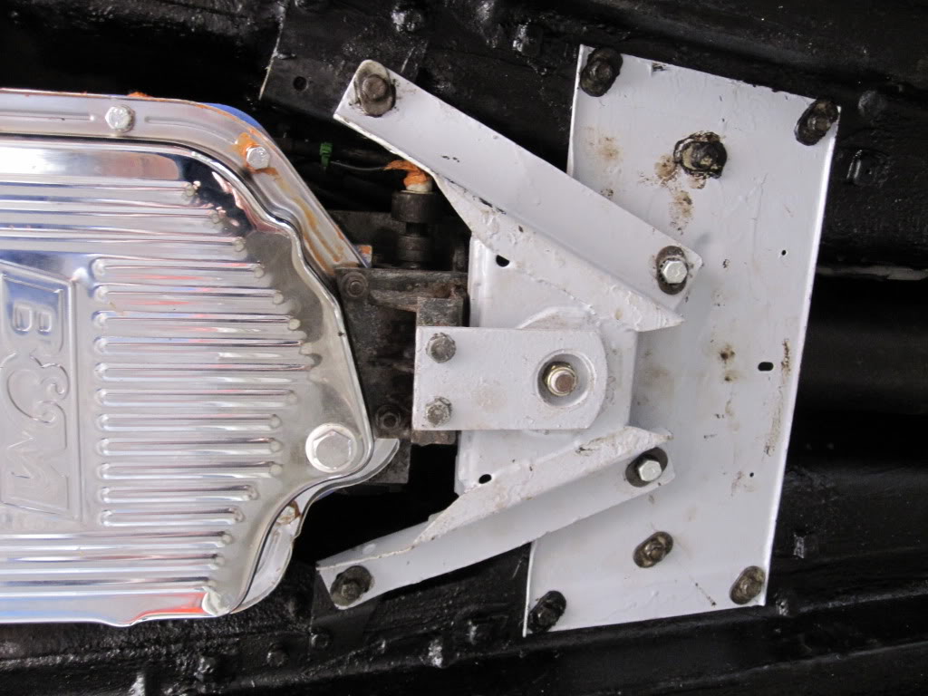

So you discarded the v shape plate that bolts to the floor basically? Still have the monster spring?
No certainly not. The piece Grant is talking about is the darkish metal coloured irregular shaped bracket you can see in this pic, that is attached to the shiny new sump and also attached by two bolts to the grey 'tongue' pointing forward from the V shaped bracket.
The grey V shaped bracket is in effect the 'shelf' the tail of the gearbox via its damping spring is sitting on.

Thanks Greg, damn that brings back memories, or nightmares.
That darkish metal monstrosity above the short plate is what is removed, and now that the memory in jump started (thanks again Greg), it is a requirement to remove that spring plate arrangement just to get at the bolts inside that junk.
That short plate with the BIG nut and the 2 bolts is also not refitted. That is the plate that can be cut/ground into shape, to give the washer that will be required to go back under that BIG nut.
Sadly it is NOT a fun task, but the fact that the trans pan will simply fall out of the gap once that bracket is removed, makes trans fluid servicing significantly easier, so adding to that, it will actually get done more often, coz it is now a simple task, mmm.
