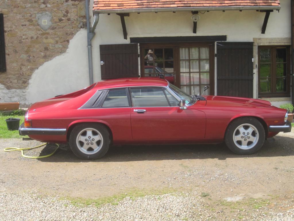

16 inch XJS facelift rims require no speedo recalibration - probably no 16 inch rims do. I changed my 15 inch starfish for 16 inch "modern starfish" from the facelifts. Great move. I run 16" 225 x 60s and there are loads of tyre options instead of practically none. Also over here insurance can be invalid if a car is shod with tyres that are not rated for its top speed, even if it is illegal to do that speed!
FWIW I believe that XJSs look better with more solid spokes, but that is entirely a matter of the eye of the beholder.
