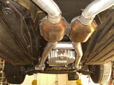

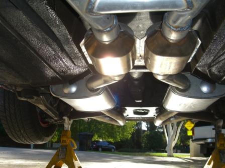

the floors flat..idk what yall are talking about
Attached Thumbnails Not enough headroom-catalytics.jpg   Not enough headroom-exfront.jpg
