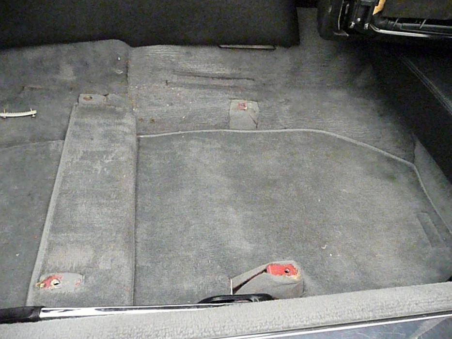

I got off the couch and took a look.
Everyone is partly right:
-there's a 3" riser under the distal rear corner that could be chopped, but
-constraints in the shape of the non-flat floor prevent the front of the seat from being lowered, and also the medial rear corner, however
-there appears to be a second set of holes in the runners where they bolt to the floor, though the front holes will have to be made bigger, so the seat could be remounted an inch further back without too much trouble.
I'll let you know what happens.

There'll be welding involved. I'm gonna have to encroach on the left exhaust tunnel: cut into that roughly 3x3 section that runs down the inboard side of the driver's floor so I can lower the rear seat mount. The outboard rear is an easy stand-alone riser.
I'll leave the front seat mounts up near where they are. I find the front of the seat a bit low as it is.
PHOTO: Taken through the left door. Seat mounting nuts are about 16.5" apart L to R, about 13" Front to Back.
