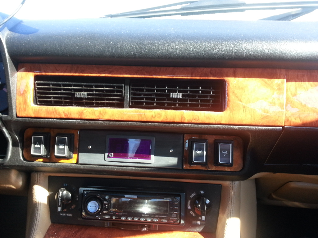

Hopefully I just posted a picture! In this shot you will see that my trip computer is gone and replaced by a narrow band air/fuel gauge. In addition my wood was in horrible shape so I sanded it smooth and re-veneered it with 3M di-noc vinyl clear coated with 3 coats of clear. Most of the wood has been done this way and it looks great! Very easy to do as well. More pictures to follow.....

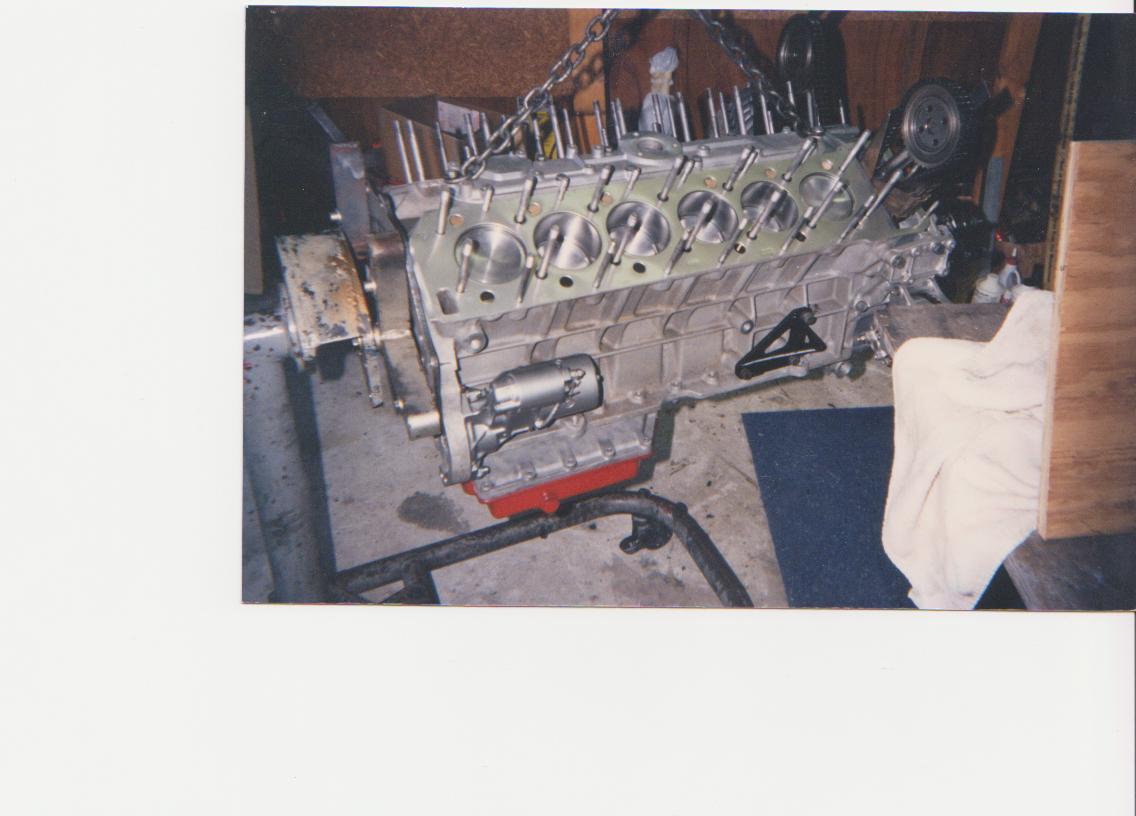

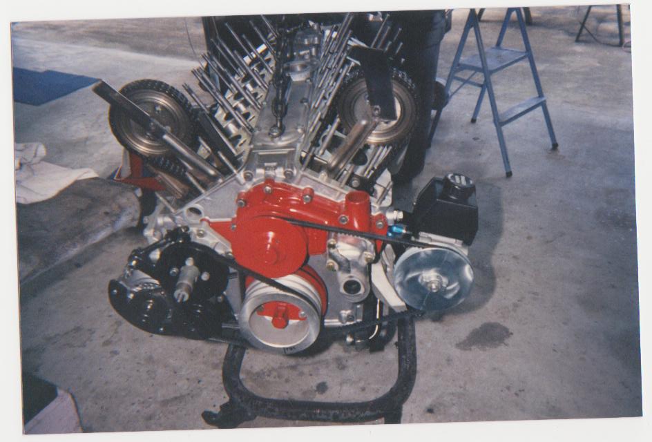

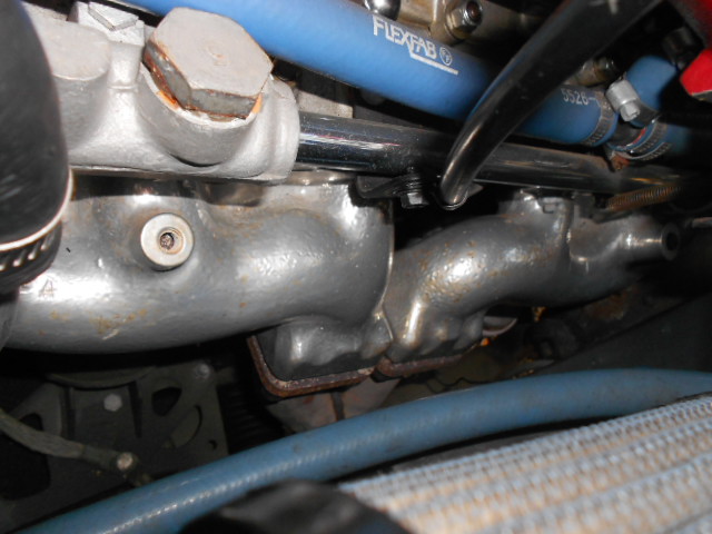

Default just a couple mods ,78 XJS rodster
i'll join the party.
some pix of couple mods, i love mods , anyone can just buy a standard car, but mods are kool!
all mods done by me,everything including body,paint,engine trans,suspensin, interior, but i bought the seats ,and dash veneers. spun Burlwood,still perfect.
notice gage left of consul A/F ratio.
all done 18yrs ago, yikes has it been that long,actually had the car 20yrs this yr.
no door handles,(key fob). wide rear fenders.
Attached Thumbnails Not for the faint of heart!-jag-rodstr-016.jpg   Not for the faint of heart!-jag-strips-10-22-2012-001.jpg   Not for the faint of heart!-jag-strips-10-22-2012-004.jpg   Not for the faint of heart!-jag-strips-10-22-2012-006.jpg   Not for the faint of heart!-jag-strut-brace-mom-ridin-shot-gun-v12-exhuast-mani-001.jpg
Not for the faint of heart!-jag-strut-brace-mom-ridin-shot-gun-v12-exhuast-mani-008.jpg   Not for the faint of heart!-center-consol-j-bond-system-003.jpg   Not for the faint of heart!-center-consol-j-bond-system-001.jpg   Not for the faint of heart!-jaguar-engine-build-process-001.jpg   Not for the faint of heart!-jaguar-engine-build-process.jpg

I like it. Your wood looks pretty good too. Could you maybe paint the 2 rivets (?) on either side of the gauge also flat black ? They kind of distract your eyes a bit.
Unfortunately because I have a dodgy fuel gauge I rely on my trip computer to prevent me from running out of gas. I have fitted aftermarket gauges (fuel pressure and oil temp) to my car and I was thinking about putting them where the trip computer was....... might try a change one day.
I see you have the updated 2 way center vent mod done....... that was one of the best/easiest things I've done to the car

Any info on the cross brace that goes across the engine... home made ? Is there enough clearance to the hood ? Do you run a hoodliner ?

Actually I am not familiar with the vent mod. Is this something that was done by the previous owner?

Yes. The standard center vent for your car was a 3 way vent. Only the small left hand side and right hand side parts could move. probably 2/3 of the air went out of the middle of this vent and straight onto the back window, or the rear passengers that can't actually fit in an XJS. As you will know, you only get air out of the center vent when you have the A/C on, so this made the A/C "feel" less effective. Having ran the car with A/C both ways I think it's partly psychological because I could get the small cabin freezing without the upgraded center vent, but somehow having cool air blowing on your face seems to make you think the car is colder.
The 94 and up cars came with the 2 piece center vent you have, so now you can redirect all of the cool air and freeze the driver and passenger if required. It's an easy 15 minute job to swap them over..... just pull the center wood trim part off then I think the vent pulls out..... or its 2 screws..... easy anyway

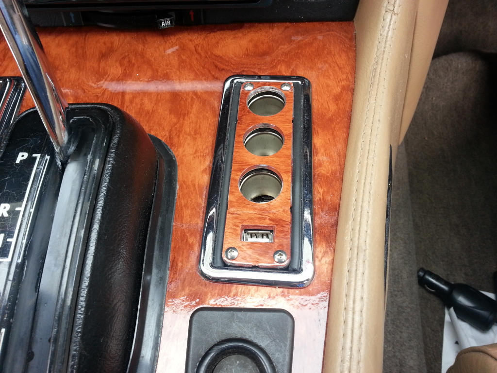

And now it is installed
This is my 12v/USB solution. I got tired of my Garmin adaptor falling out of the stock cigar lighter. I have another face plate with the wood grain in the correct orientation drying now.
Attached Thumbnails Not for the faint of heart!-20130322_140645.jpg   Not for the faint of heart!-20130322_140726.jpg

Power-wise, I've been running a Black and Decker 100-watt power inverter ($8 at HomeDepot), it has a USB port and a 115-volt AC outlet. It doesn't sit in the shallow lighter receptacle as securely as I'd like, but I'll either install a deeper one or integrate something like you did.
