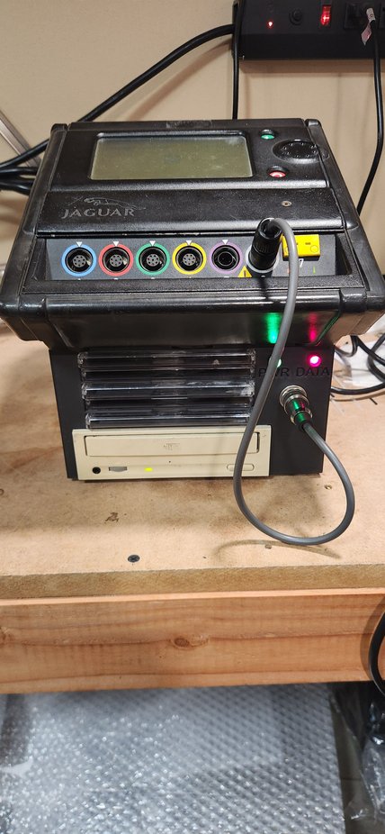

Originally Posted by Jagman99R
Yeah, I went and checked it out. Seems a bit pricey for something that they can't say wether it works or not. Could be an expensive paper weight. I could change all the solenoids and more for that amount. Thanks for the heads up though. I guess I would need a lot more than just the PDU anyway so it probably would be useless for me at this point.
I purchased the same unit from this seller. I replaced the battery and it works fine. I made a 3d printed box to hold the power supply and new board and CD reader. Costs- aside from the PDU itself (currently 550.00 for the ebay one), power supply was like 25.00, board shipped around 200.00, CD player, figure 20.00 on ebay, cable you need to make along with connectors- figure another 30.00 to 40.00. Total 835.00 I believe you need this unit to be able to work on the 6.0L engines in the later models with the ODBII connectors.
