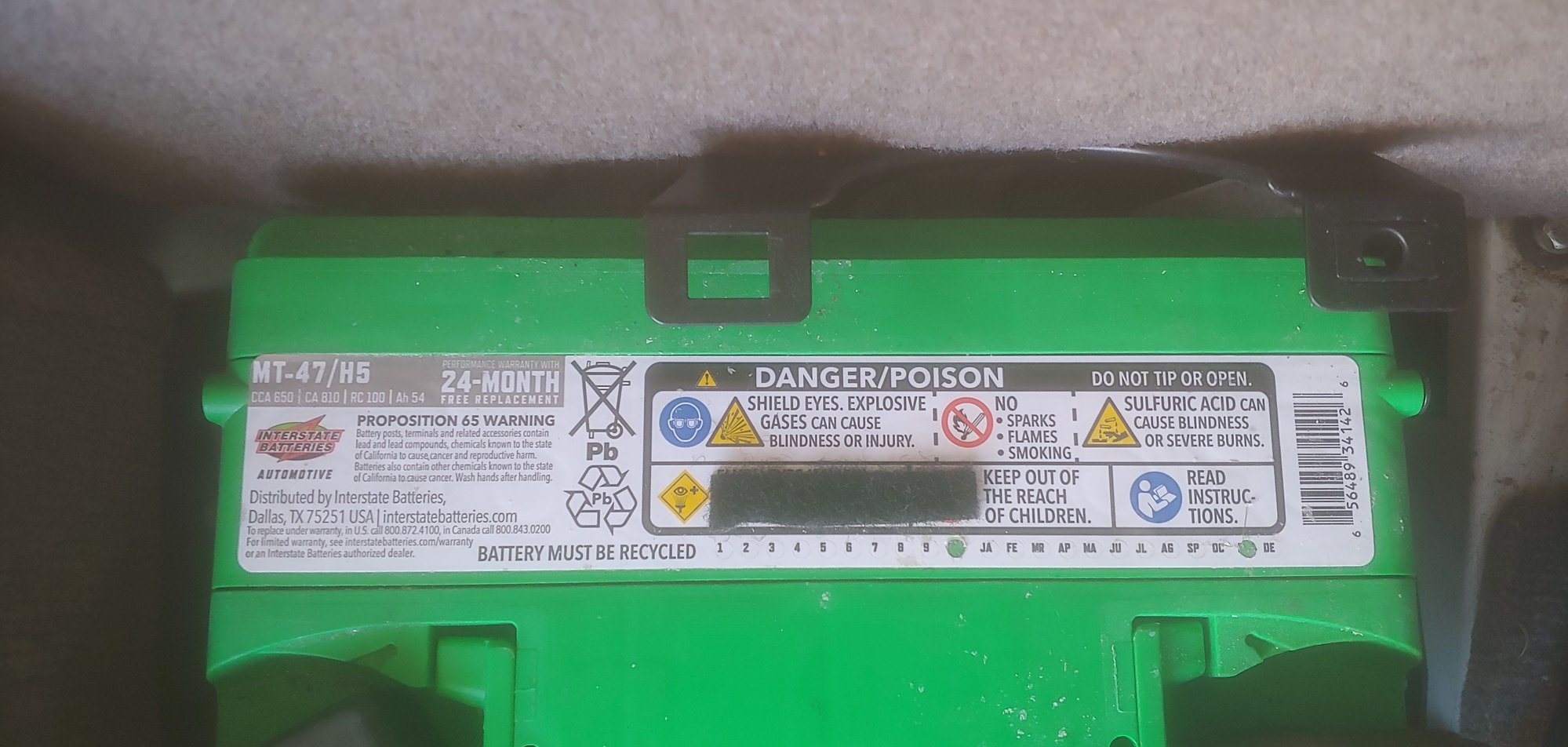

I really don't get the issue here. After 25+ years in the auto parts industry, replacing a battery is a "no brainer" if you go to a mfg shop like Interstate. Believe it or not, I've had an Interstate in my 92MY convert for 10 years. Yes, you read that correctly...10 years! I think that speaks to 2 important elements...Jaguar moving the battery to the trunk with a cover and a reputable battery manufacturer. As an aside, driving the car regularly (current mileage @ 210K) may have an impact and it's the type that has no "add water" aspect to it.
Dave in AZ
