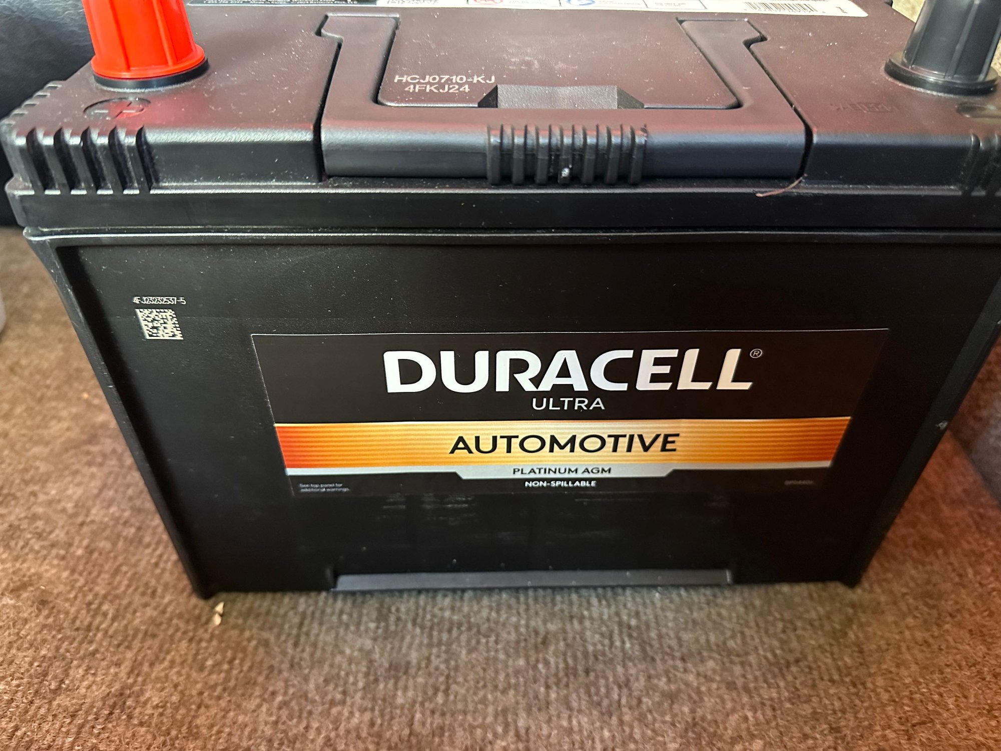

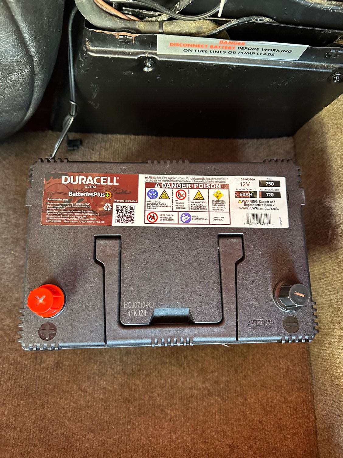

Thought I would respond to this thread should it help anyone. I recently replaced my battery in my 1990 XJS Convertible. I read a lot of conflicting information on the web regarding what battery was the right one and which size battery would fit in the metal battery tray in the trunk.
AutoZone (I’m in the USA) said I needed an AGM 34 battery. For my install I needed the positive terminal to be on the left. AutoZone did not have the battery in stock and I’m not really sure they were still stocking it. I ended up finding it at Batteries Plus. It was the Duracell SLI34AGM Ultra Car and Truck Battery | Platinum AGM | 750CCA | Group Size 34. It was $279. This battery fit just right in the metal battery tray and all is working well.
https://www.batteriesplus.com/produc...Code=VI1430611
The dimensions of the battery were: Weight: 42 lbs, Length: 10.2 in, Width 6.8 in, Height: 7.9 in
I was replacing an ACDelco 24PG which a prior mechanic threw in the car about 4 years ago. This battery never performed well, and I was glad to replace it. It wasn’t the right size. Personally I’m not a fan of GM / AC Delco anything.
As to the whole venting/not venting thing. I checked with my jag mechanic and he said the new batteries do not need to be vented. My prior battery was not vented and there were no issues. I don’t know if they make vented batteries anymore as I couldn’t find any in my research.

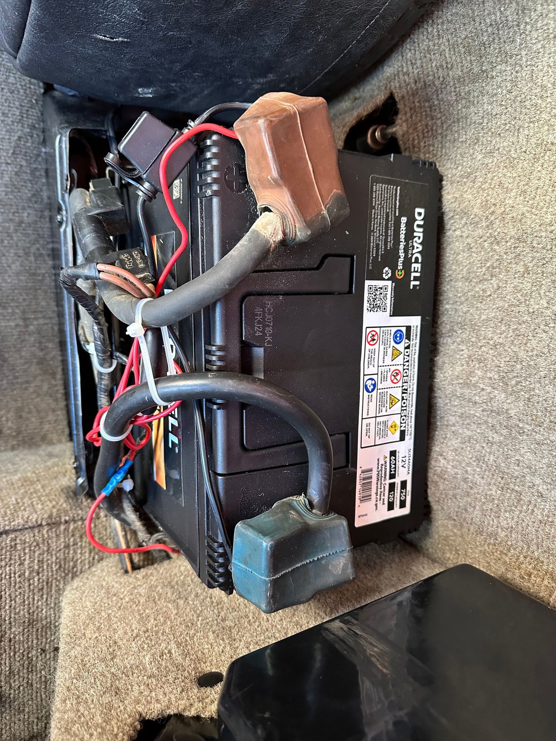

This is the new battery installed. Positive terminal on the left. I have the battery tied down with J Bolts and a metal bar across the top. The XJS plastic cover fits nicely over this battery.
This is the new battery installed. Positive terminal on the left. I have the battery tied down with J Bolts and a metal bar across the top (this is not shown in the above picture, but you can see the tie down in the last picture with the old battery). The XJS plastic cover fits nicely over this battery.
The handle on this battery was a huge help with getting this battery in place. It is heavy.

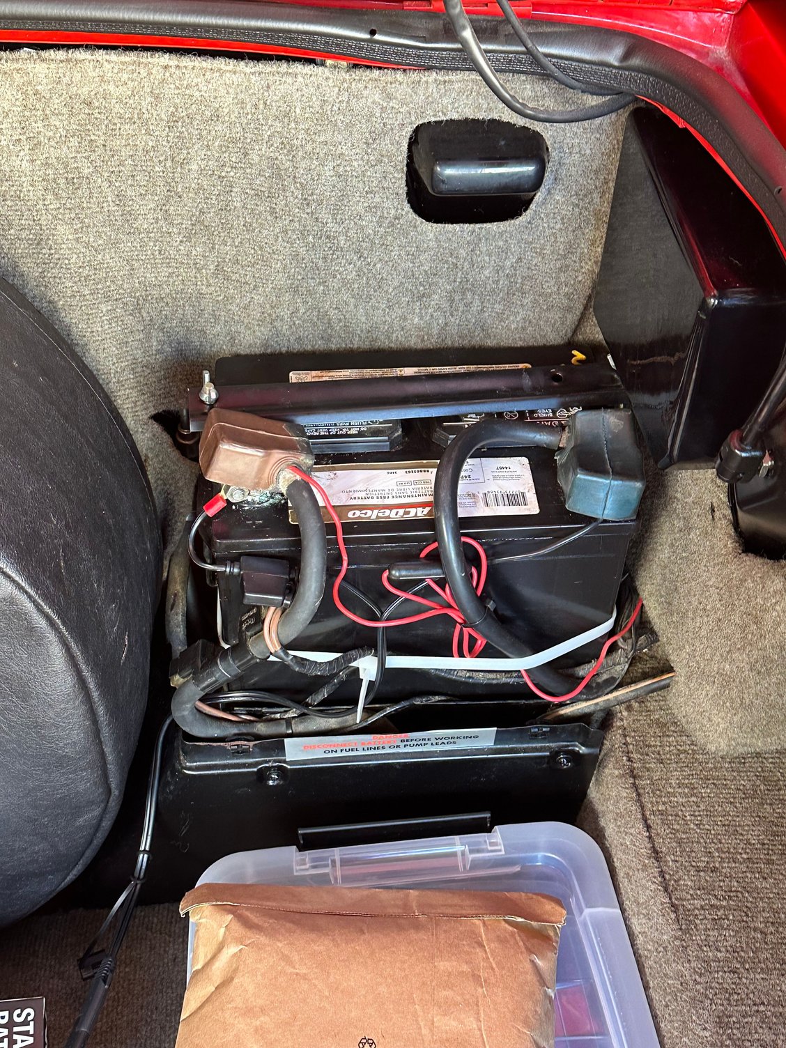

This was the old AC Delco battery that did not work well.
