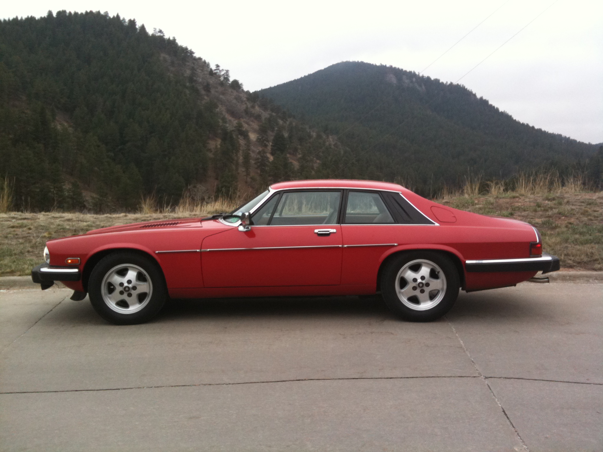

this 86 XJS has a transplanted 6.0L , added these hood louvers to vent out hot under hood
air, says it helped substantialy. also added a larger engine oil cooler than factory!
on my V12 i have tested temperatures ,and after a 1/2hr run, rear of heads are at 180-185F, but top of cam covers run over 210-220F, i am giving it serious thought about a larger cooler, already have a better trans. cooler.
admitdly i have had no engine problems, except NORMAL rear crank rope seal leaking oil.
