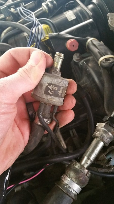

The first part is this little vacuum valve. One end of the vacuum line is hooked to the bottom of the A side manifold, it has a couple electrical connectors on it that look like they might go to the secondary fan (which isn't kicking on for me, but I believe that's because my AC system is inop at the moment) but I'm not positive. the other end of the valve looks like it might have a hose that is supposed to go to it, but I'm not sure what the deal is there.

The first one is the Extra Air Valve. It slips into a grommet on the back side of the A-bank (right side) air filter housing. When the a/c clutch is powered-up, the valve opens to increase idle speed a bit.

as stated above,
the blue valve is a ' dump valve ' for the cruise control and is a safety feature to ensure the cruise bellows isn't holding the revs up at all
the extra air valve compensates for extra engine load for AC etc
