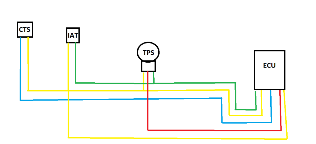

according to my schematic, the TPS loom is wired properly.
Old Jun 8, 2012 | 01:04 PM
  #78
M90power's Avatar
Joined: Oct 2011
Posts: 1,738
Likes: 70
From: WV
this is exactly how mine is wired. i forget exactly which ECU pin corresponds.

Try putting in a spade connector back near the ECU plug in for the two CTS leads and run a new connector and new temporary wires. Just run them up over the top of the car, and just for the CTS, to bypass the entire wiring harness. This will rule out the loom entirely. There's way more to the wiring loom than just the underhood stuff you've replaced.
When I did control work for commercial HVAC installs, I had a school where I couldn't pick up about half the thermostats on the network. After searching for weeks I found where a careless dropped-ceiling installer had put an anchor right through my network wire.
D
Old Jun 8, 2012 | 04:08 PM
  #80
M90power's Avatar
Joined: Oct 2011
Posts: 1,738
Likes: 70
From: WV
so just duplicate the CTS & low side TPS wiring?
5 and 19 are the two pins ill be rewiring, right?
