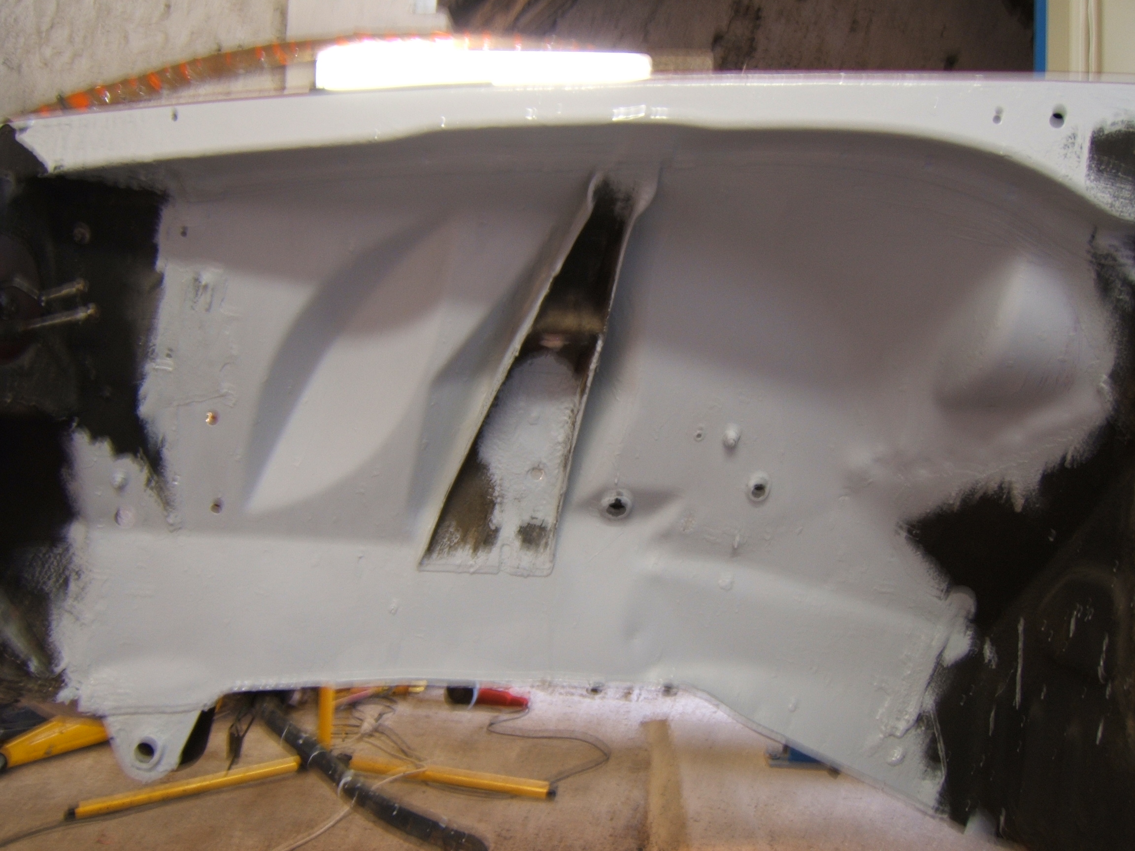

While you are in this wheelarch area, take a look at the strengthener in the wheelarch, the piece of steel that runs vertically to the hole for the top of the shocker. As you probably know, water gets behind this piece and rots through the sheet steel, so a hole appears in the engine bay. Once all fixed, I carefully rust-treated and then carefully using top grade 3M seam sealer, sealed up the join top to bottom each side, between the strengthener and the wheelarch panel. With luck this will stop future water ingress.
