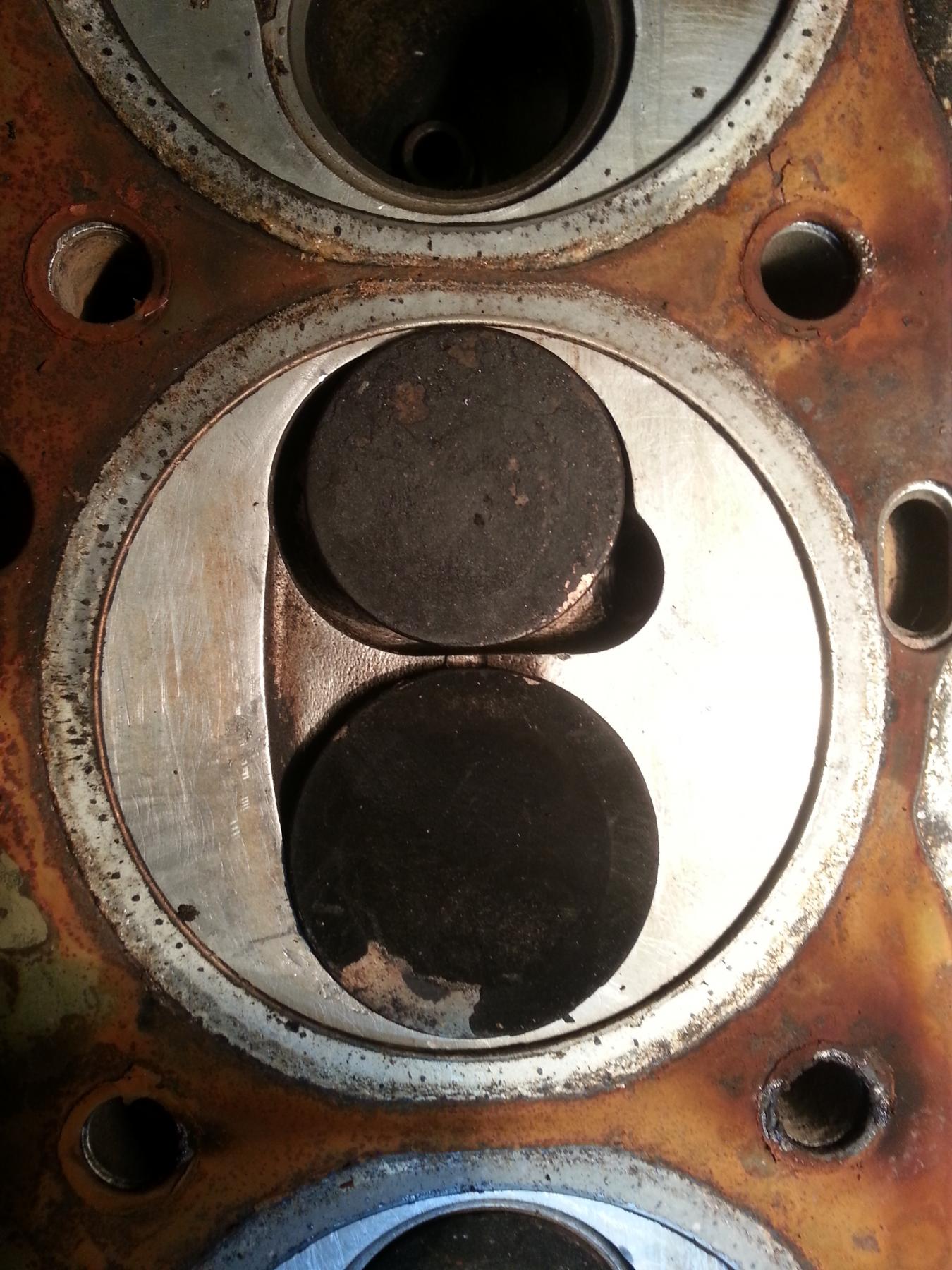

The heads I posted were part of 20 pair that were cast for Group 44. Supposedly, Jaguar spent a couple of million on the development of these.
I have no idea what to do with them now. I bought them with the intention of building a 6.0 street screamer for my 71 XKE. A turn of financial events has me no longer owning the E type. Ideally, I would like to sell them (I think), but I gave a fortune for these, knowing that it was a once in a lifetime event.

Thanks for posting the head pics. These look to me to be basically a flat head design from their appearance. Presumably the chamber was in the piston crowns. Certainly they seem to be nothing like an HE head from the combustion chamber in the head point of view.
Greg

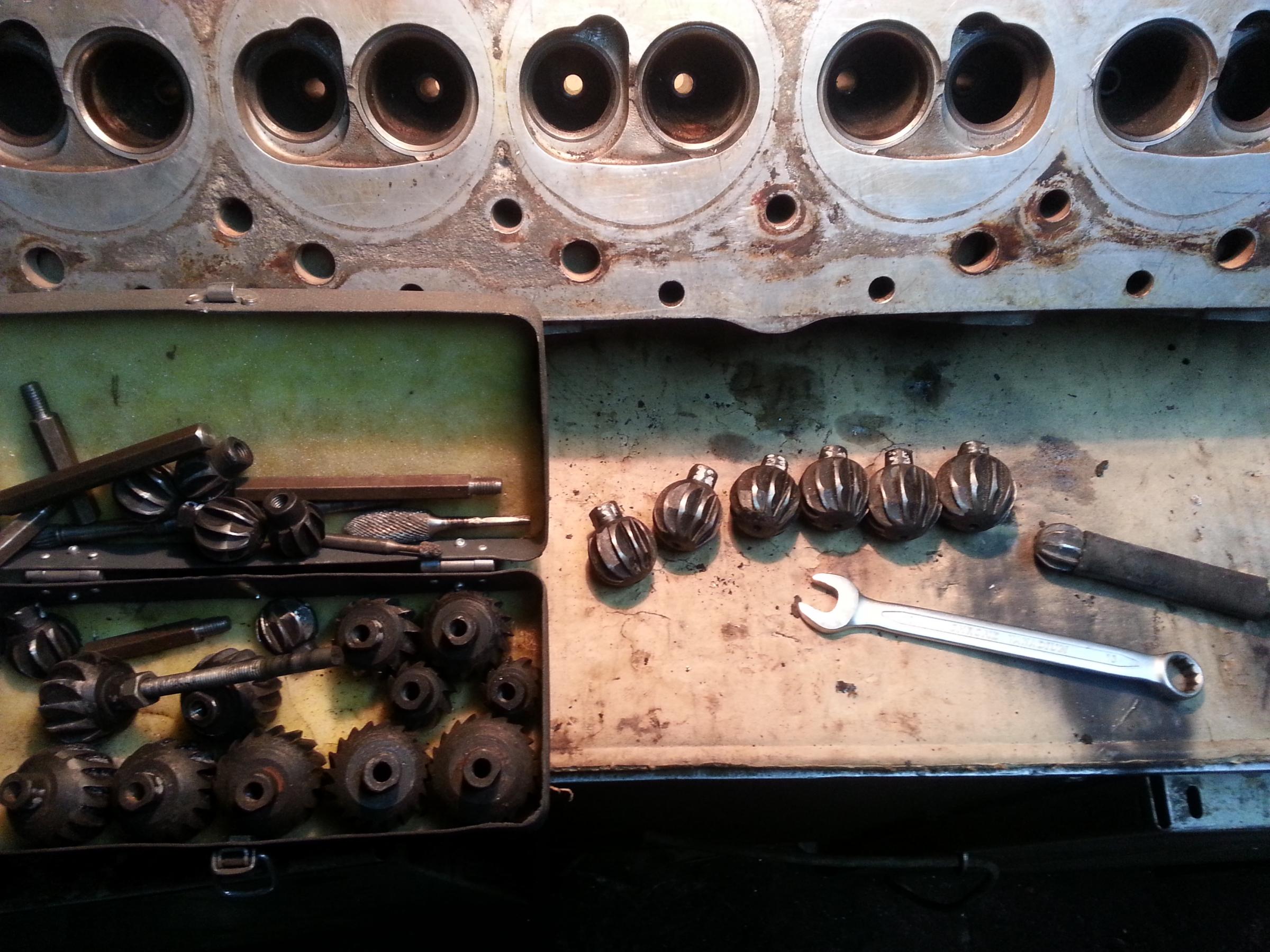

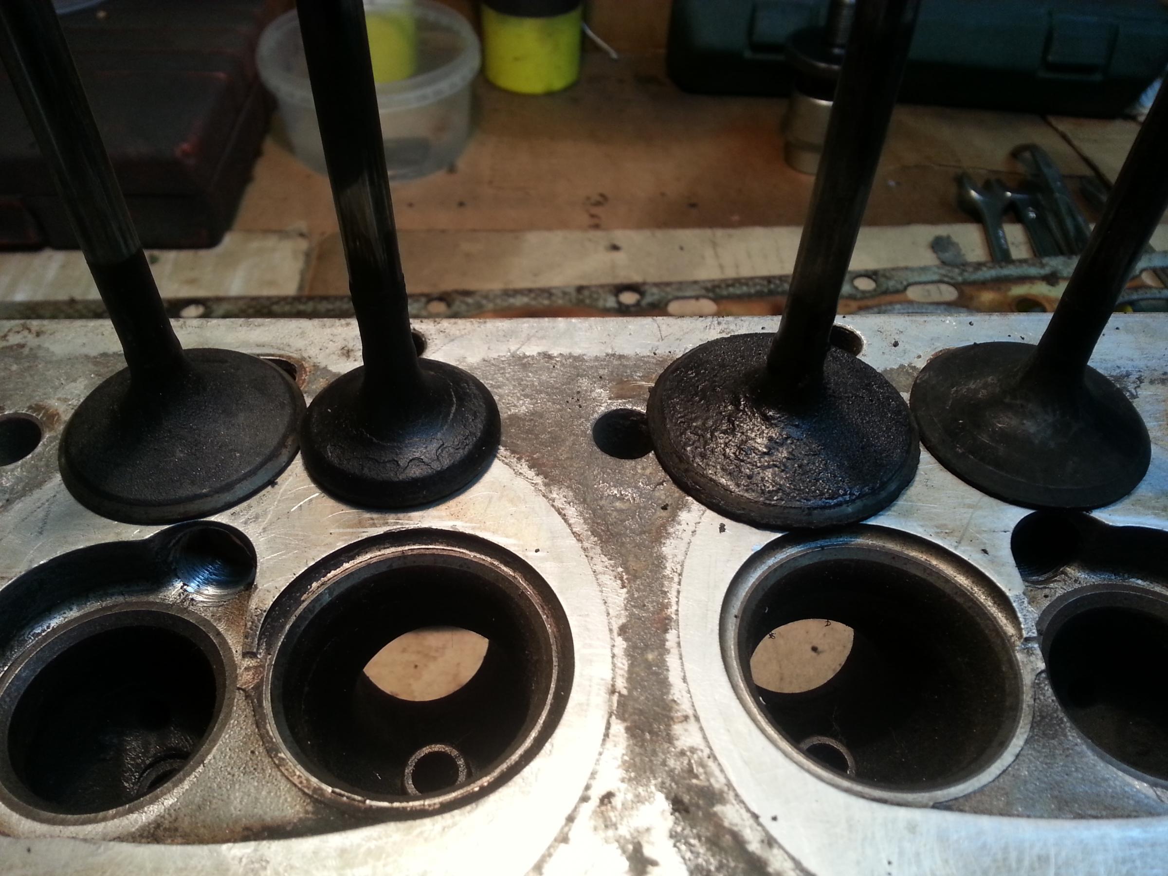

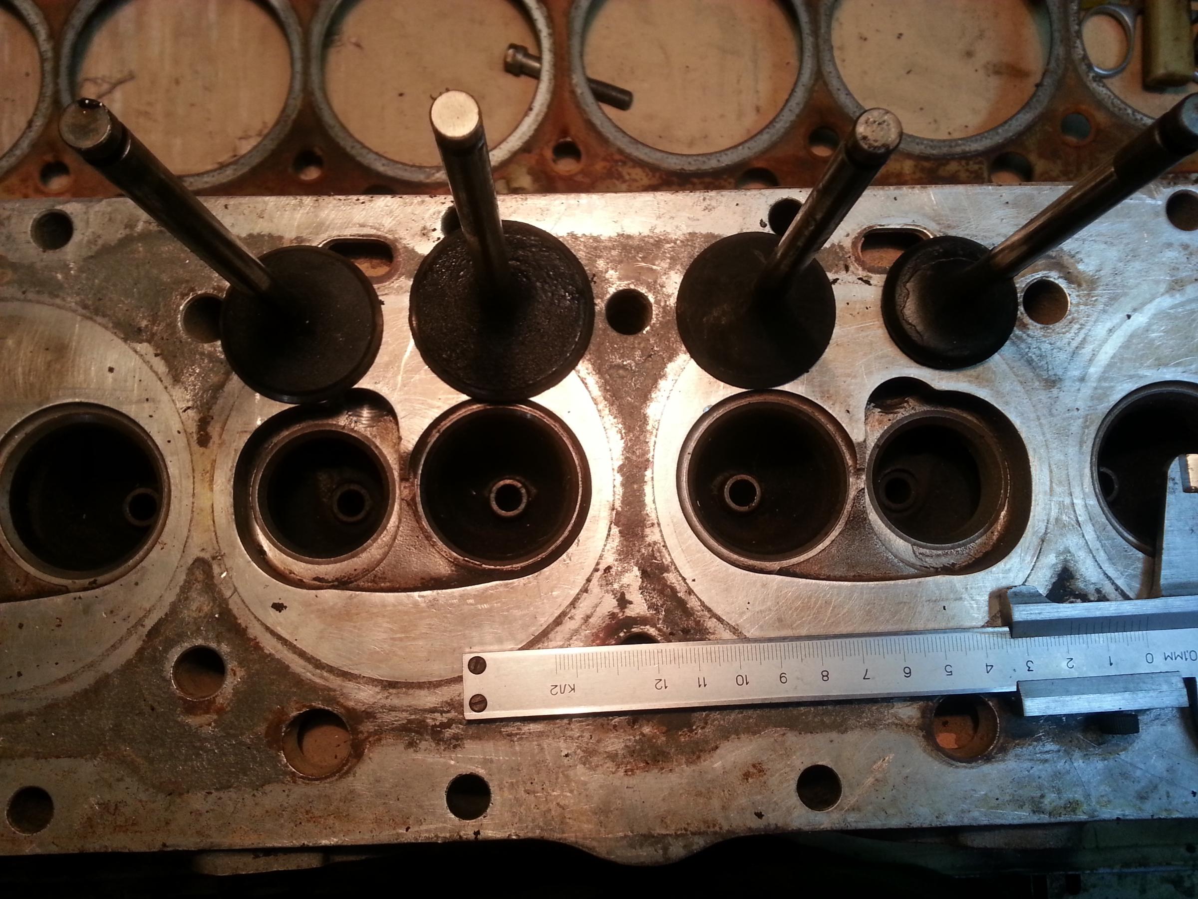

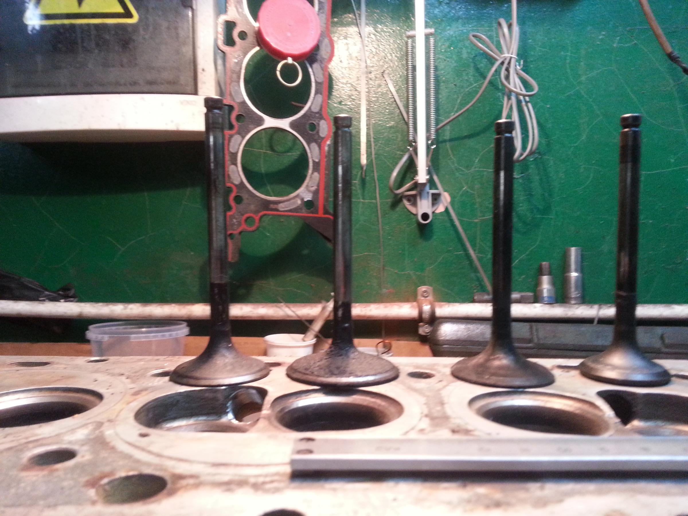

comparing the size of the valves V12 and XKE 4.2. inlet 35mm-42mm. forgot to measure exhaust
Attached Thumbnails Ported HE heads-2014-07-24-14.51.02.jpg   Ported HE heads-2014-07-24-14.51.13.jpg   Ported HE heads-2014-07-24-14.52.18.jpg   Ported HE heads-2014-07-24-14.54.35.jpg   Ported HE heads-2014-07-24-14.54.54.jpg
Ported HE heads-2014-07-24-14.55.37.jpg   Ported HE heads-2014-07-24-14.55.43.jpg

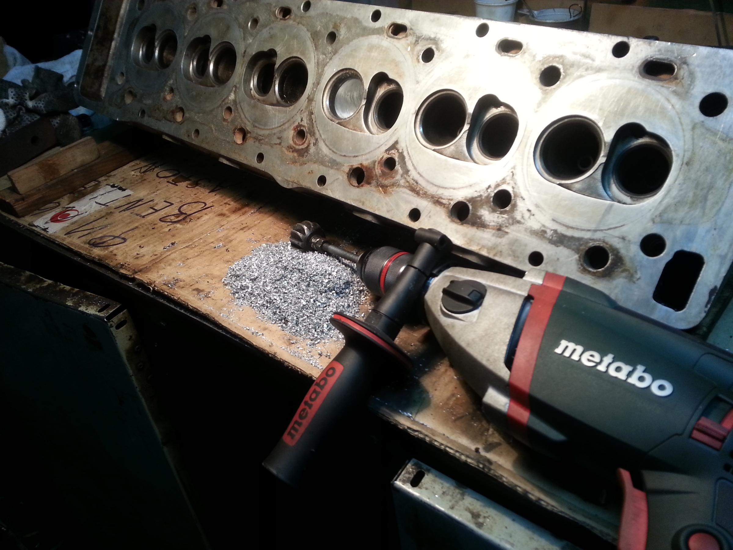

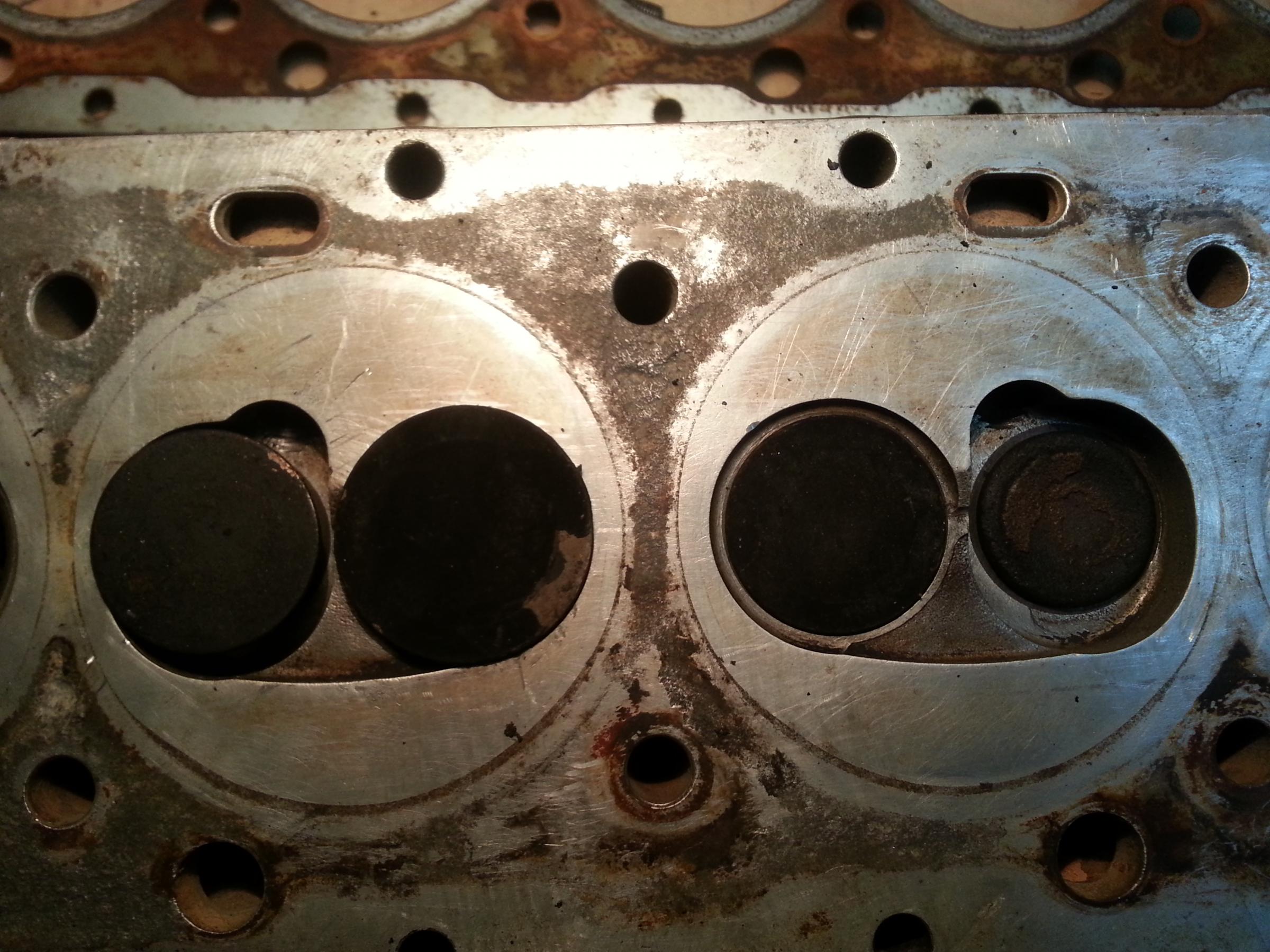

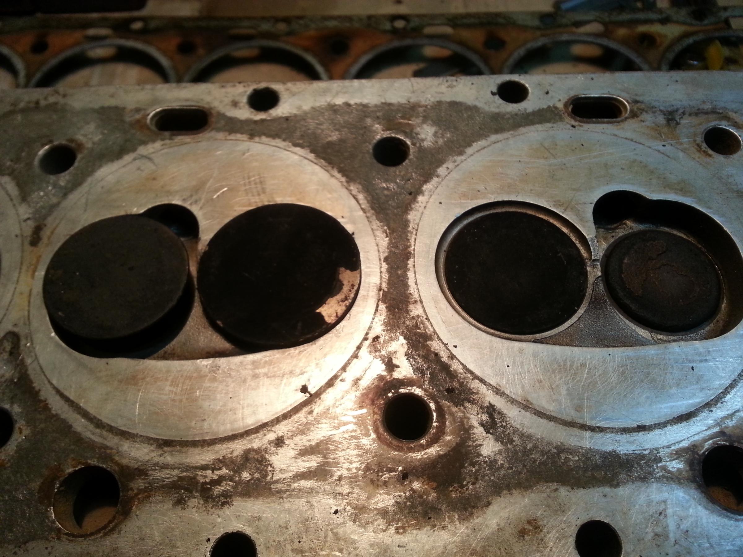

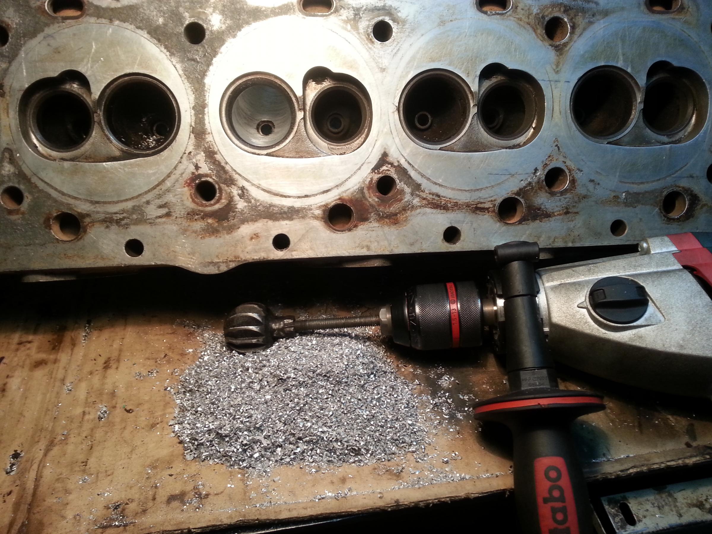

process
Attached Thumbnails Ported HE heads-2014-07-24-15.11.25.jpg   Ported HE heads-2014-07-24-16.25.17.jpg   Ported HE heads-2014-07-24-16.25.34.jpg   Ported HE heads-2014-07-24-16.26.15.jpg

and donno if anyone noticed sjsv12, uses an unusual porting tool ,never seen anything like that!
could really hog out the port with a set of those,(and keep port round), and it looks like they can be resharpened.
veerry interesting!

They are interesting and seem like the right tool for a European style round port. I think we don't see tools like often here in 'merica because since about the late 40's domestic performance intake ports have been square.

the Russian guys tools are unique, but he did remove some metal in the ports(as i see it),that took away some induced swirl in the bowl area just before the the valve seat.
could be corrected by welding in a small bump or deflection wall swirl shaped.
