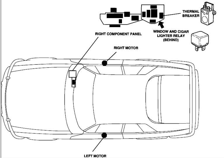

Originally Posted by pzjaguarv12
Both do not work , and I Purchased that way.
Where is circuit board and relay?
At the RH panel below/behind the glove box.
I'll try to find a pic for you
DD
I looked at panel under passenger glove. But what I found didn't match my book pics
The attached diagram might help
Do you have a test light or test meter?
DD

Originally Posted by mikebaker3
The Thermal circuit breaker opens when hot, but there are two, so one for each side.
Only one breaker for both windows.....on the older models such as the 89 in question, at least. There was a circuit change in 89 , though. Earlier 89s had the breaker upstream of the relay. Later, it was moved downstream
Thanks everyone. I do have a new switch I have already tried. I am getting power to the switch. I have taken apart under the glove box and I believe I found the relay. I haven't tested it yet. It's been raining ,I've been busy and my garage is full. I will fix soon
Power to the switches comes *from* the relay and circuit breaker. So, since you do have power at the switch, your relay and circuit breaker are OK.
Since a new switch did not fix the problem then you have a problem in the door (motor dead, possibly) or a wiring fault between the door and he switch.
Did you try the new switch for both windows, by the way?
DD
