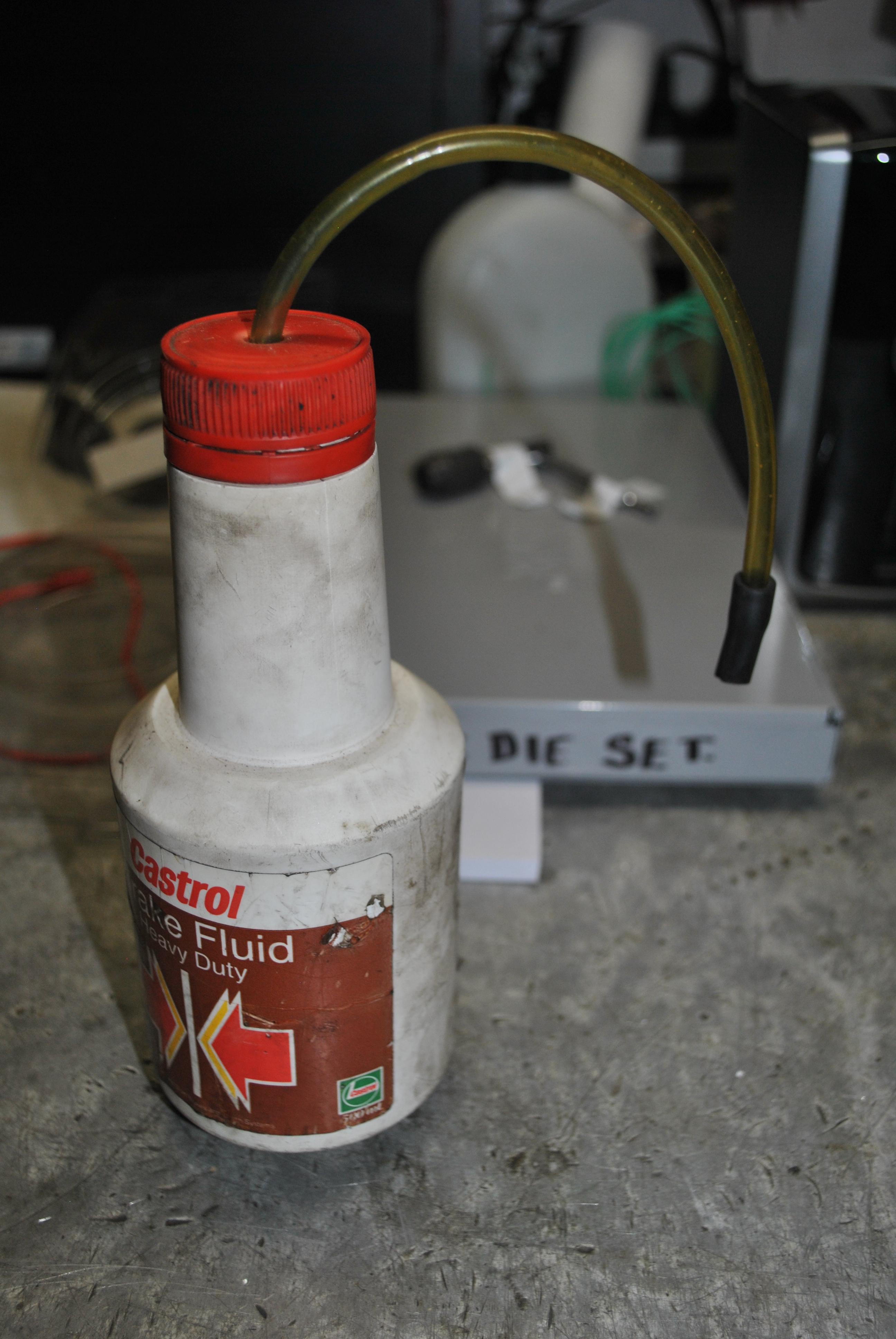

Great work Paul, it's all about having a go and asking questions. The answers flow here to get the job done right.
Your new brake bleeder looks just like the one I made in 1989 and still use today. Even the same tube still in it, although I wouldn't try bending it too far these days.
