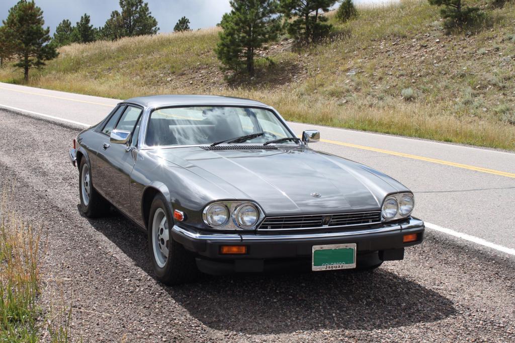

I got the 'new' XJS ('85 US Spec V12) home and cleaned up (awesome car very low mileage, last painted in late 80's under warranty!), and have been tending to a few things, however I have a question pertaining to partial throttle.
Once the car is warmed up, she pulses while under 1/4 throttle. Once you give it the Welly, there are no issues.
Is this a function of the EFI (design) not liking partial throttle, or do I need to check for more air / vacuum leaks? Or??
