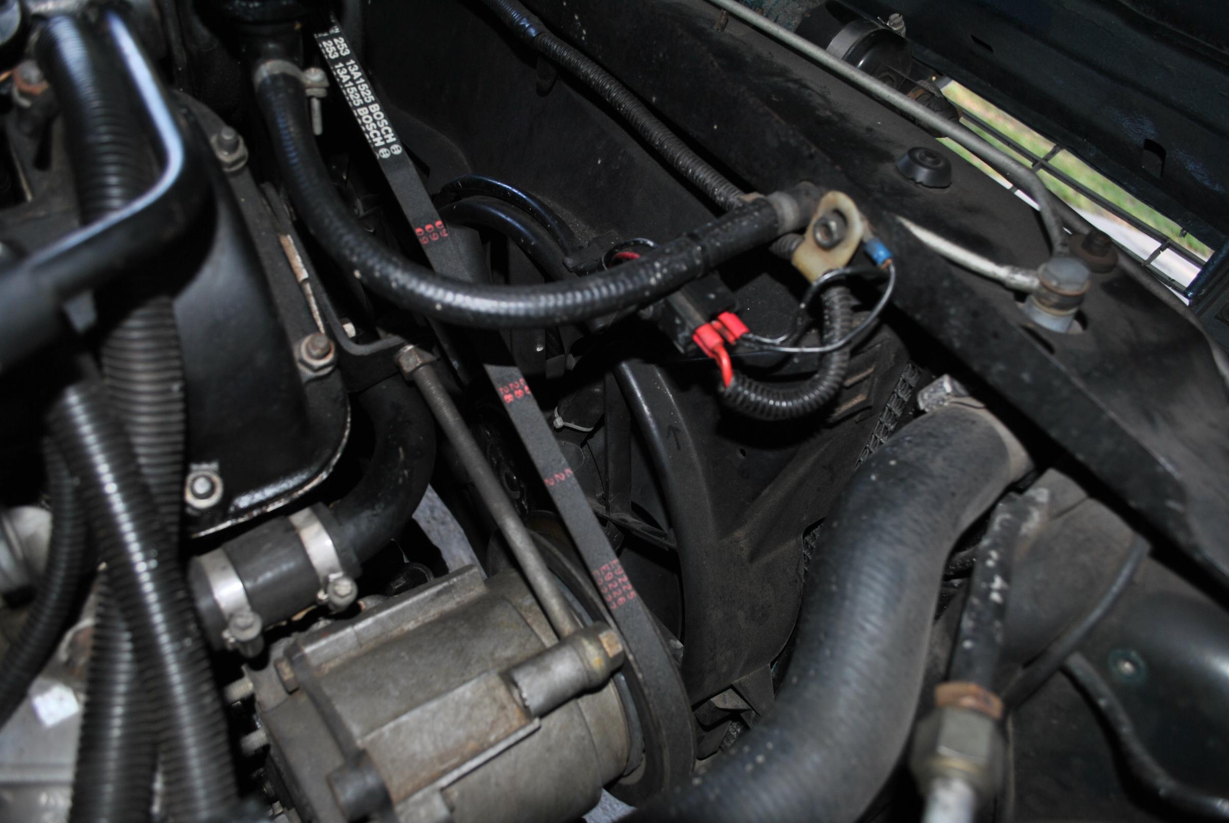

Greg in France wrote: "Ensure the aux electric fan is wired to come on all the time the heater/aircon unit is on (easy to do, just run a wire to the fan positive from the aircon compressor clutch activation wire"
To which I say: Any hints as to where that might be? I see two wires going into the belt driven A/C unit on top of my engine. I'm a simpleton, I know but I'd like to make this one small mod a reality in my car but I'm not clear which is the clutch activation wire.
Thanks in advance,
Rhett
Thanks in advance,
Rhett
When you turn on the aircon, one of the wires to the compressor goes live to activate the compressor clutch. If you disconnect the two wires at the plug, aircon on, ignition on, engine NOT running, one will be live and one will not. Identify the wire that is live with a test light or meter, this is the wire you want.
Once found, next find the thermostatic switch on the inlet to the water pump. This will have two wires going to it, and the switch looks like a big brass nut with two wires coming out of it. Again, ignition on, engine NOT running, test each of the two wires to see which is the live one. In this case also the one you want is the NOT live one.
The purpose of the thermo switch is to activate the aux fan when the water gets hot enough. The NON live wire connects to the aux fan relay and carries current to it when the thermo switch closes. If you follow the non live wire from the thermo switch you can find an easier place to do the following:
Make a bit of wire to join the live wire from the compressor to the NON-live wire from the thermo switch. Now, when you switch on the aircon and whenever the compressor is activated by the system, current will also flow to the aux fan and it will run.

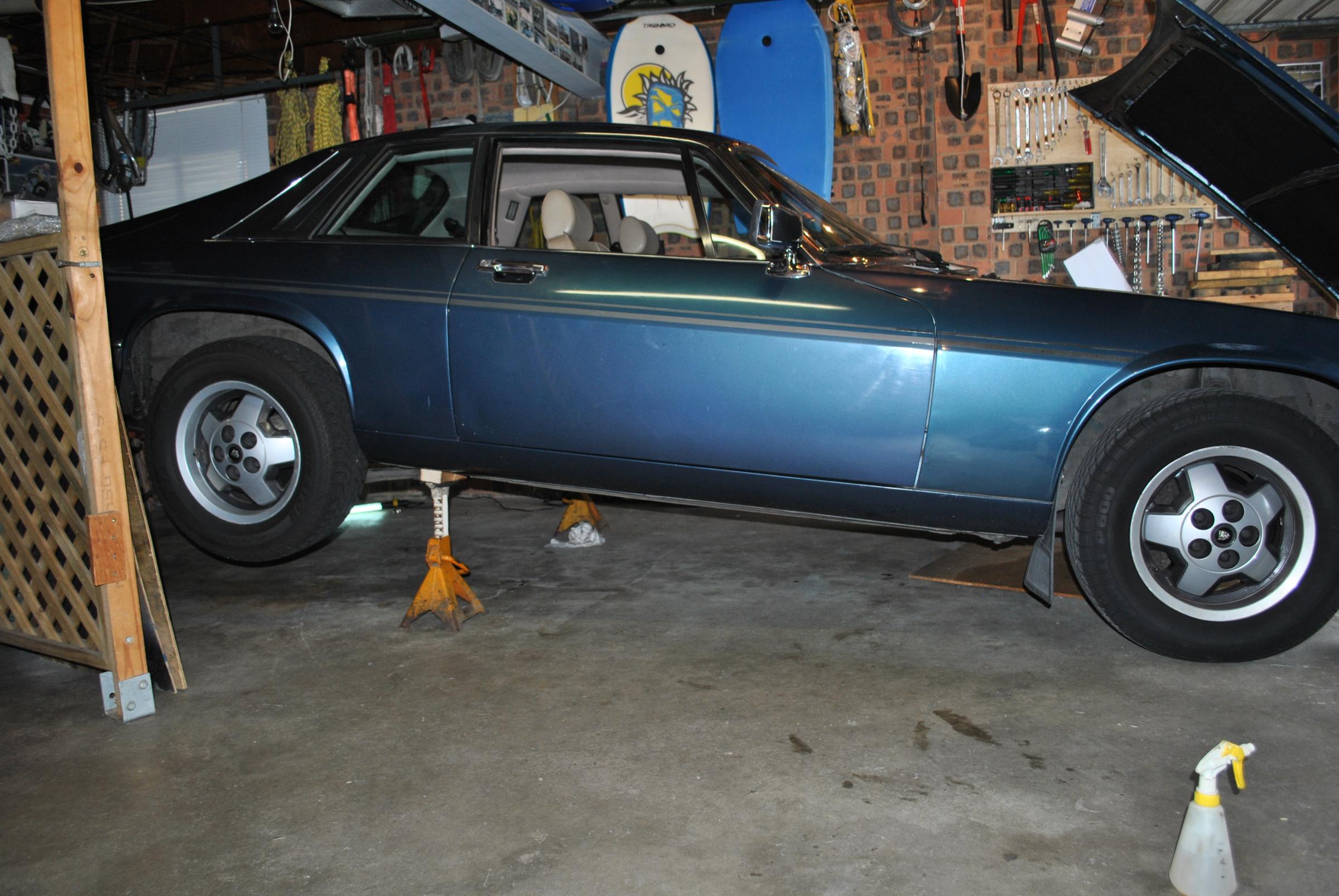

27 beers gone and 1/2 a bottle of Paul's best duty free scotch done with ice(made from water). Paul has retired for the evening! Just at starting time.
As you say in the USA, three strikes and you are out! After the third attempt at reversing into my garage(with enough tyre chirping to bring the neighbours out) Paul was out of the drivers seat and I got to floor another car up my drive in reverse into a space you cannot see.......one attempt, perfect,no damage to car or house.
Rad out ,hoses done, beer consumed then we had lunch. Jacked car and checked over IRS while consuming more beer(exactly as Grant Francis said it would be....IRS sweet and number of estimated beers consumed)
Then a phone conference with "Grant Francis" to make sure we were on track, more info(setting timing) for tomorrow given and picked up rad from shop and retired up to the BBQ for the evening.
Cooked BBQ while having scotch and beer, rad back in tomorrow.

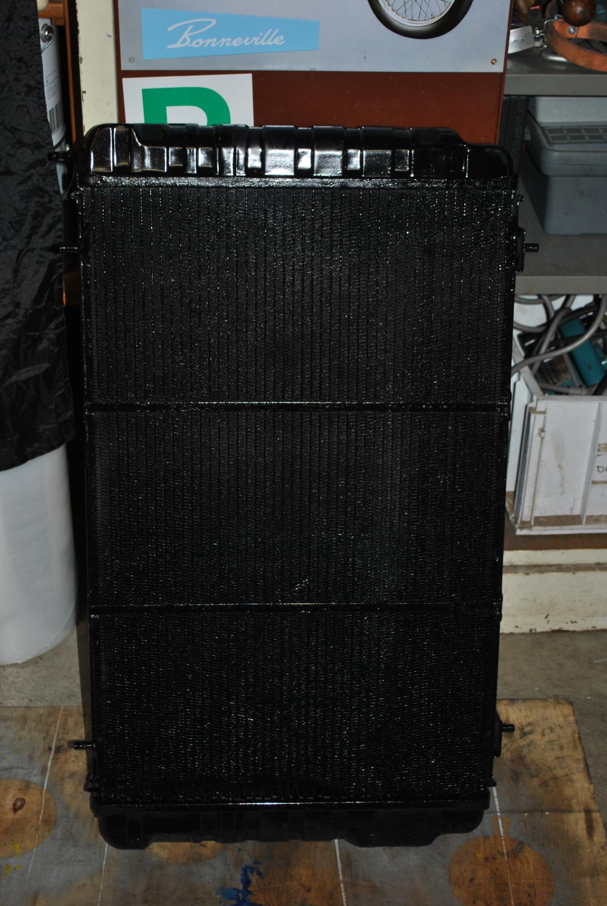

Radiator shop claimed 60% blocked.

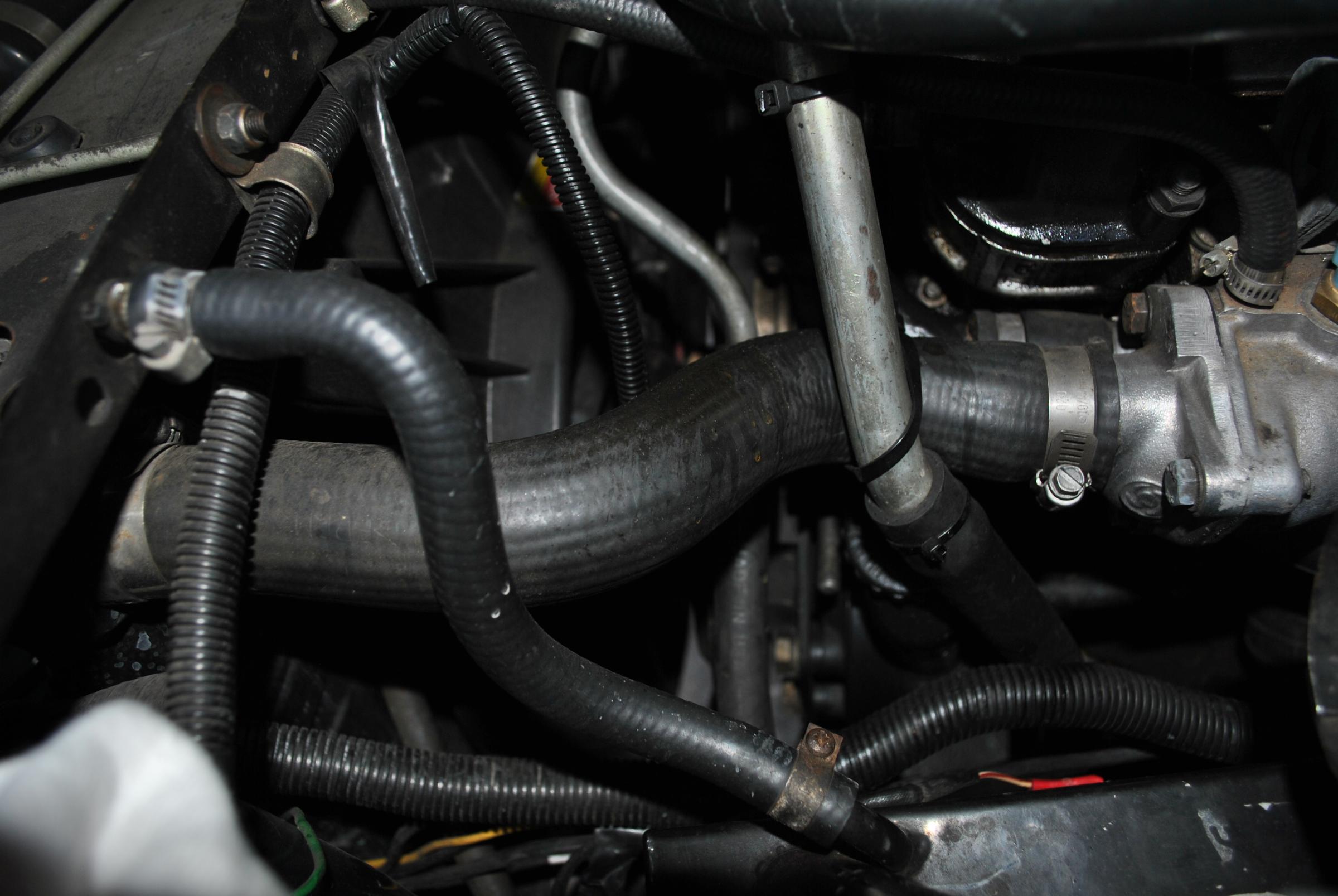

Removing the radiator was fairly easy compared to others I have done before, lots of space on the XJS to work with. Bonnet on still left ample work room. I thought the V12 would be harder to get around. Only had to cut one hose and that was because it was stuck on with silicone(heater hose that connects to bottom hose outlet on rad) .
Hardest part of the job was replacing the three hoses on the bypass pipe across front of engine without removing air con compressor. But we got there eventually after removing oil breather housing.
After a chat with Grant francis
Bleeding the cooling system was straight forward and a lot easier than assumed.
