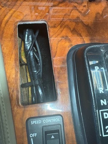

Does anyone know where's the inline fuse for the radio in a 1992 Jaguar XJS V12? I saw in another thread saying that it's under the ski-slope ashtray. I removed the ashtray but couldn't find any such fuse.
The radio does not turn on. The security light isn't lit either. Both fuses #7 and 6 for the radio power and radio memory are good.

Have you pulled the radio out?
It could be just hanging from the back of the radio.
Sometimes it's accessible with the side heater ducts removed.
If not you need to remove the entire ski slope.

On pre facelifts the inline fuse is behind the radio.

The general consensus is that the facelift (1991-1996) don't have an inline fuse.
