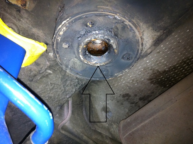

Just removed my driver's side radius arm, and it took about 2 minutes to pop it off. The passenger side took me a full day and a lot of trial and error, and some bloody knuckles, so I though I would post this for future reference, as I'm sure I'm not the only person to have this problem.
All you have to do is use two things: a propane torch and a BFH (big freaking hammer). Forget the pry bar, it's more trouble than it's worth. Once all nuts and bolts are removed, hit the mount with the torch for about 30 secs (the rubber will probably burn a bit, just be careful and have an extinguisher nearby just in case). Burn it inside the bolt hole, and all around the car side of the mount as much as you can reach. Basically evenly heat it. Then, hit the mount point as hard as you damn well can ten or so times. And I'm not kidding, use a mallet that belongs on a splitting maul. Big. Hit it up, towards the ceiling, not laterally. Repeat this cycle two or three times (heat, hit, heat, hit); mine eventually just fell off.
Hit it up towards the ceiling at the arrow.
Hope this helps someone out!

Attached Thumbnails Radius arm/trailing arm advice (giving)-trailingarm.jpg
