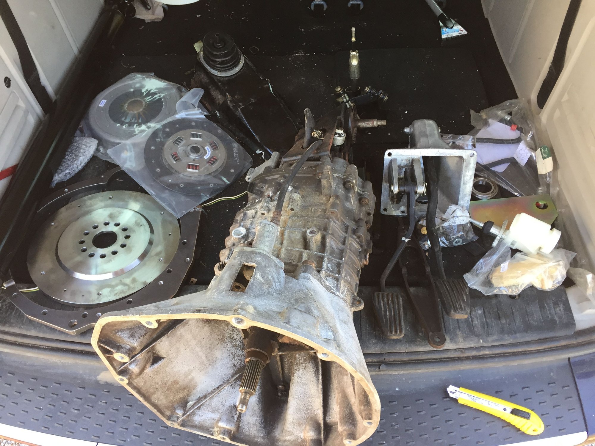

I was about to buy the John's T700 kit. I did one on a S1 XJ6 years ago.
The I see here that a T700 may not handle the high rev's without being race-built. I hadn't seen that stated before anywhere.
I have a 3.54 diff ready, as well a rear anti roll bar, which worked well on the S1 XJ.
THEN, look was pops up on my local buy and sell - a Simply Performance complete kit! I got it for about the cost of a standard T700 swap.
iscamerica's comment about the manual car being night and day over the auto, has spurred me on.
This project will have to wait until I get some other projects done first - I went a little crazy when I retired and bought a few cheap Jags to play with - but I can't wait to get started.
