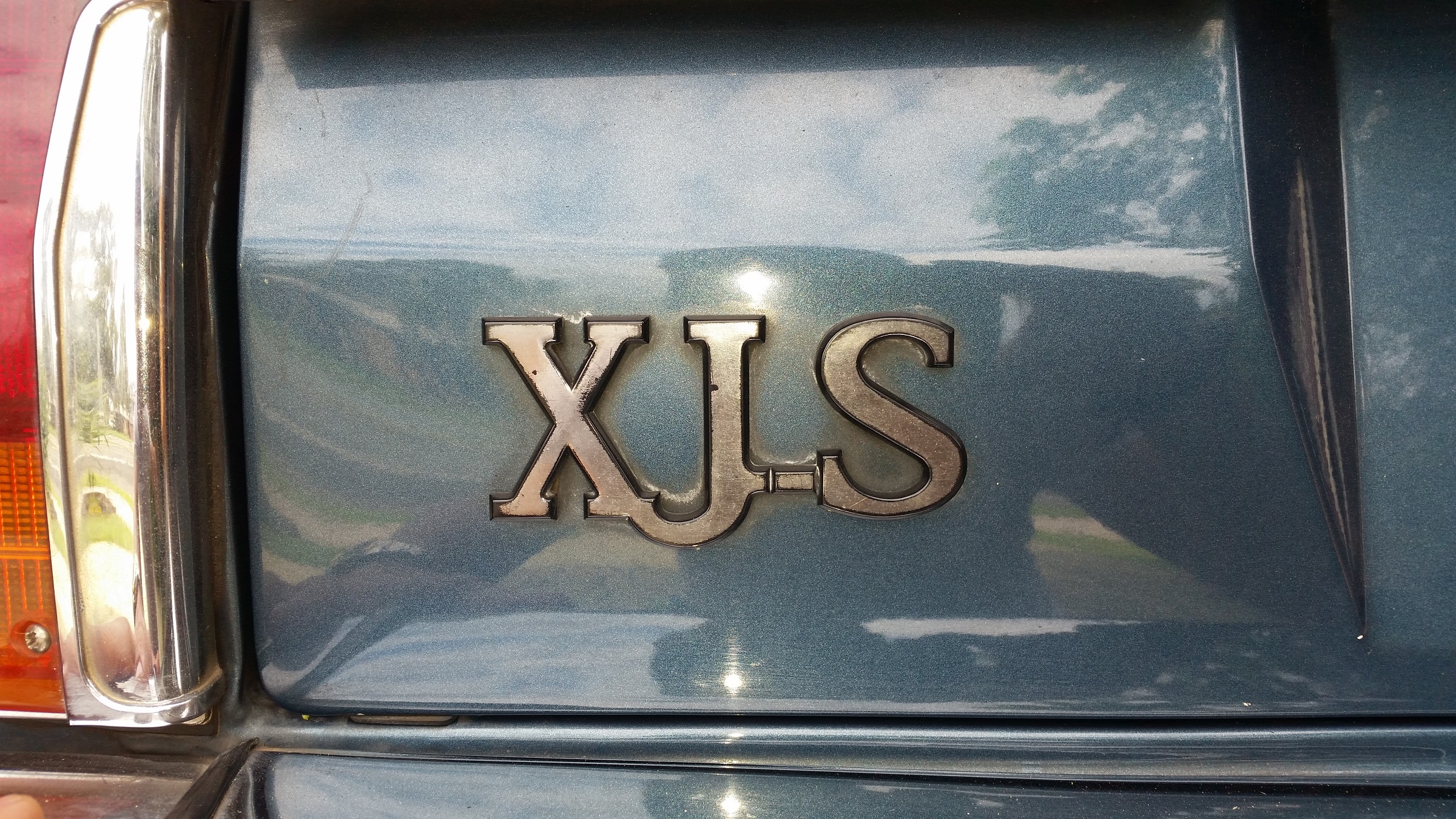

A few months ago I was a bit silly and got some Chrome cleaner on my V12 badge on the rear, RH side of my boot. Crap. Didnt realises it was just plastic with chrome coloured paint (am i the only first timer to do this?)
Anyway, having a hell of a time trying to source both the XJS and V12 badges.

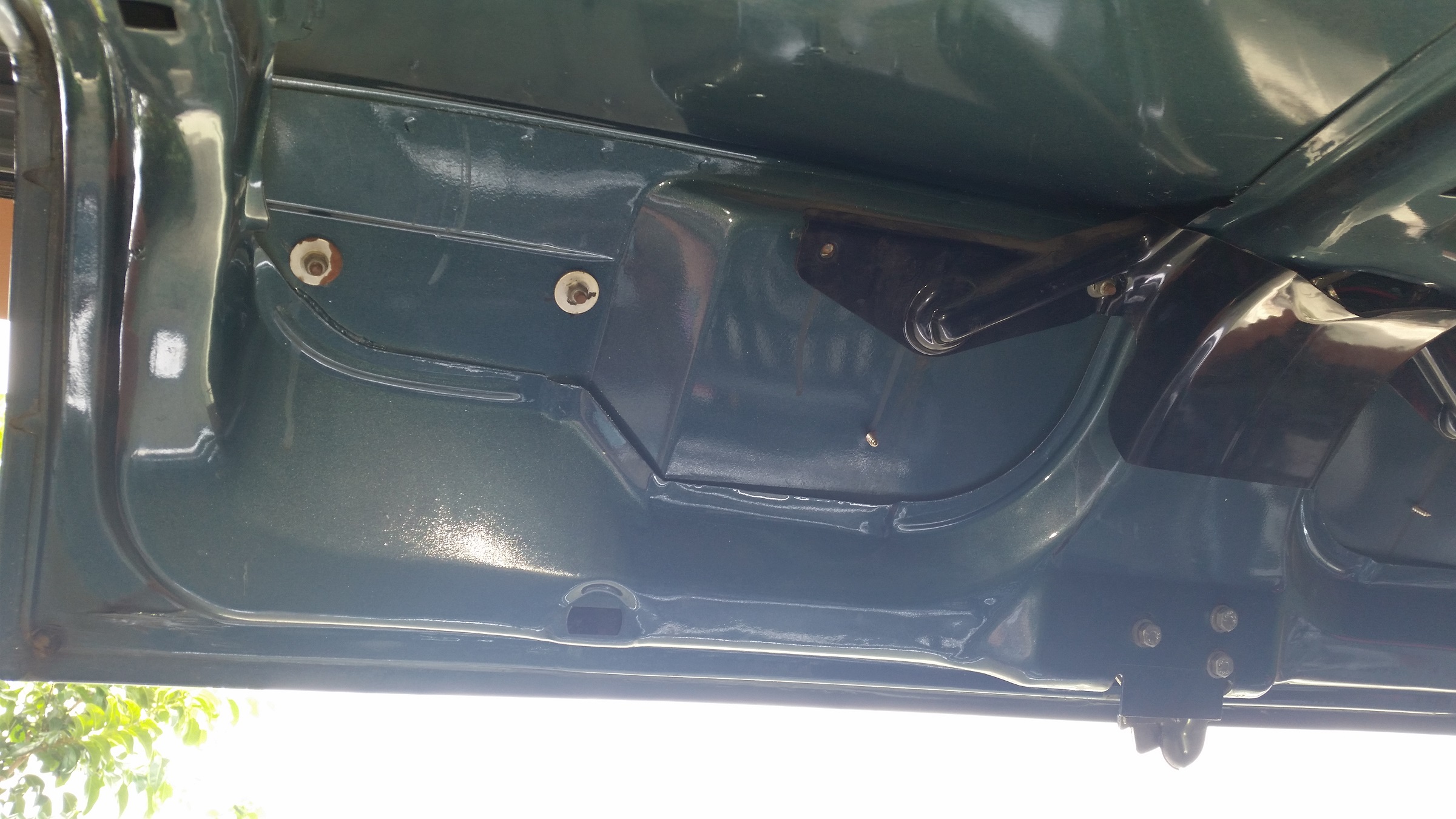

Also how the hell do you take them off? I opened up the boot and it seems you have to take the whole bloody boot apart to get into the inner wall. Any clues here? I can see light getting through on the badge from the inside so it is attached somehow, not glued.

They have alignment pins and come with sticky tape backing. I've come across new ones occasionally on eBay, the XJS seems easier to find then the V-12. I've got a NIB XJ-S one and have been waiting patiently for a new V12 one to come up.

Oh cheers mate. So they do use adhesive then? Geez I never would of thought.
I was thinking of a hack to try and repaint the badge itself. silver pen isnt reflective enough. Any clues?

On my old set I went to the hobby store and bought some silver "leaf" sheets and used that, looked better then the "rubbed off" look they were.

Oh cheers mate. So they do use adhesive then? Geez I never would of thought. I was thinking of a hack to try and repaint the badge itself. silver pen isnt reflective enough. Any clues?
Yes, there's a thin rubber layer on the back with a red plastic covering you pull off to expose the sticky.

Cheers bud. Heh that is a good idea about the silver leaf sheets too. Might be hard to explain what I want though. What else do they use silver leaf sheets for?

This is the product I used, you can get it at any art supply store.

Cheers bud thanks. So you just cut it out and stick on with superglue?
What adhesive you use to re apply the badge to the body?

You can leave them in place, the leaf I bought came with an adhesive in a bottle you lightly spread over the flat surface of the badge then after it became tacky you applied the leaf over it, pressed, then pulled the paper off and used a dry paint brush to remove any excess, the silver only clings to the area with the adhesive.

Watch this video, it'll give you some idea what I'm talking about, I guess the stuff is sizing not adhesive, it was pretty easy to do and I only wanted the shiny leaf on the flats of the emblem, worked great. Not the same is plastic chrome but a good look all the same.

I repainted the XJS badge on our XJS after the car got a paint job.
The paint shops don't seem to care about retaining the badges.
I was there when they "scraped" the XJS badge off of the trunk with a nylon
type of tool and I snagged it before they could toss it.
Fortunately, the 94 used an adhesive to hold the badge on.
I spray painted the badge with a Krylon brand Gold Chrome paint for plastic and
then used the adhesive that is used to hold weather striping on to the doors.
The Gold Paint job came out great and a year later the adhesive is still holding up.
I liked it so much I painted the other badges the same way. Now I have Gold badges
on the "Oyster" color paint job which is a sort of gold/bronze color.
You could outline the badges with a black paint using a fine paintbrush to give it
a more 3-D look.

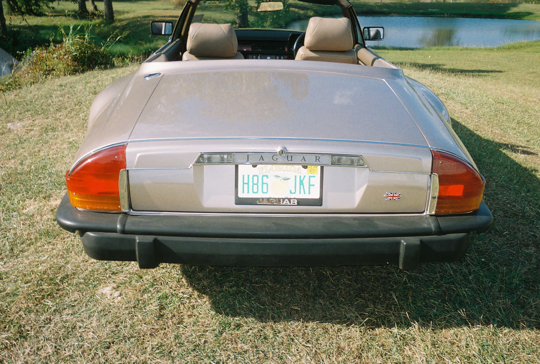

rear of my 78 XJS roadster,pix.
originals were dicast pot metal chrome peel and cracked.
