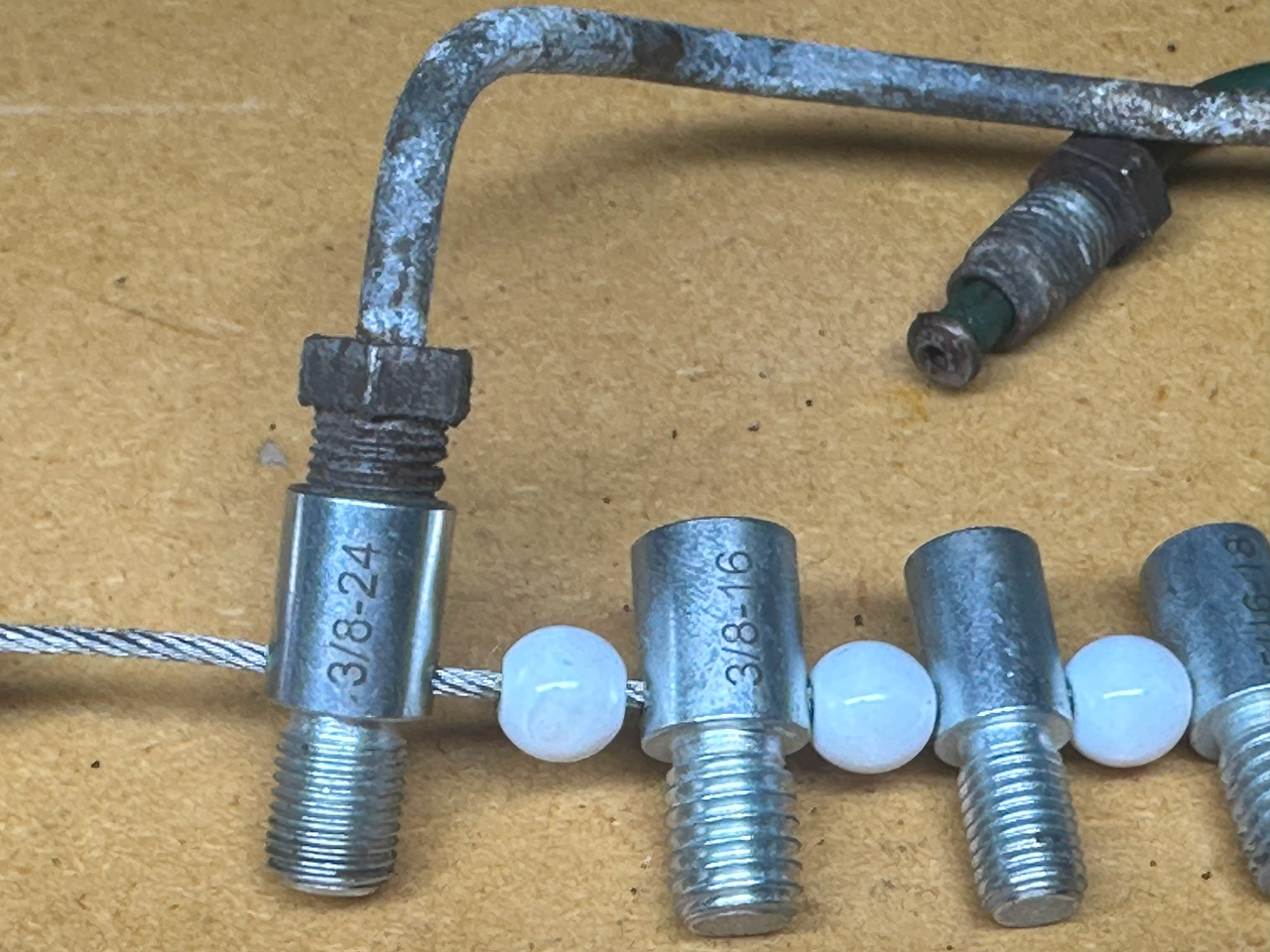

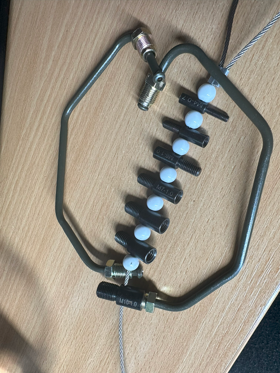

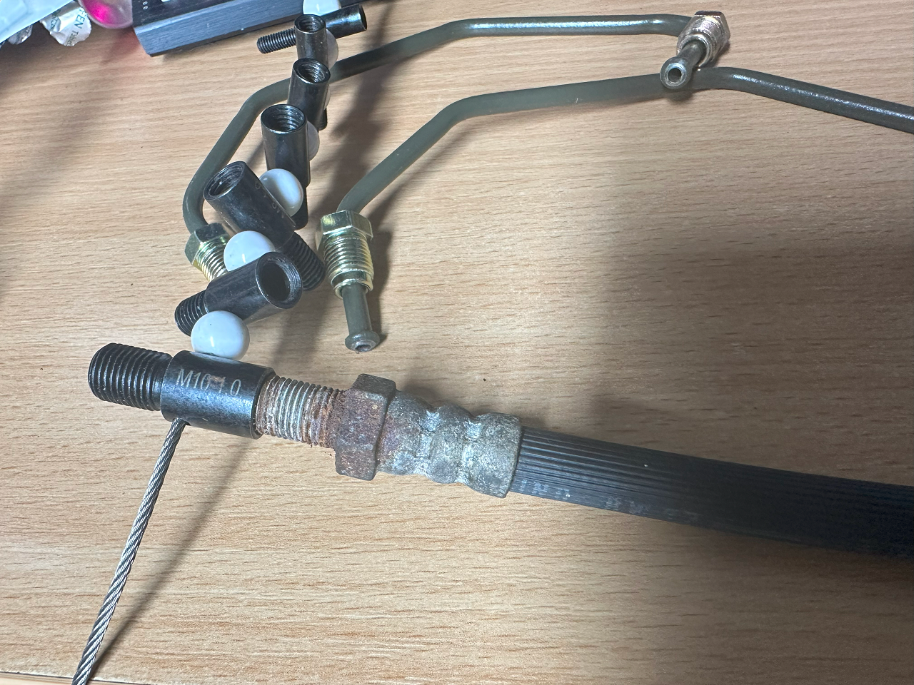

From splitter to caliper
Rubber hose - yes I do have a new one - (this isn't it)
this is the long pipe that goes from rubber hose to the splitter.
PPS - mine is not a facelift .... it is an 87
My rubber hose at the rear is M10x1.0, my metal fittings at the rear are M10x1.0 - I know I've used 3/8x24tpi on the car hence previous deleted comment - they're on my receipts ... need to locate my rear union (that shares single incomer to both calipers) and measure that but my metal pipes are M10 (bought from Jaguar while they were still available).

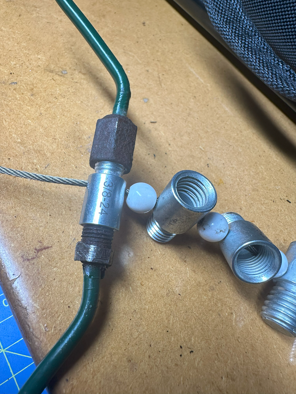

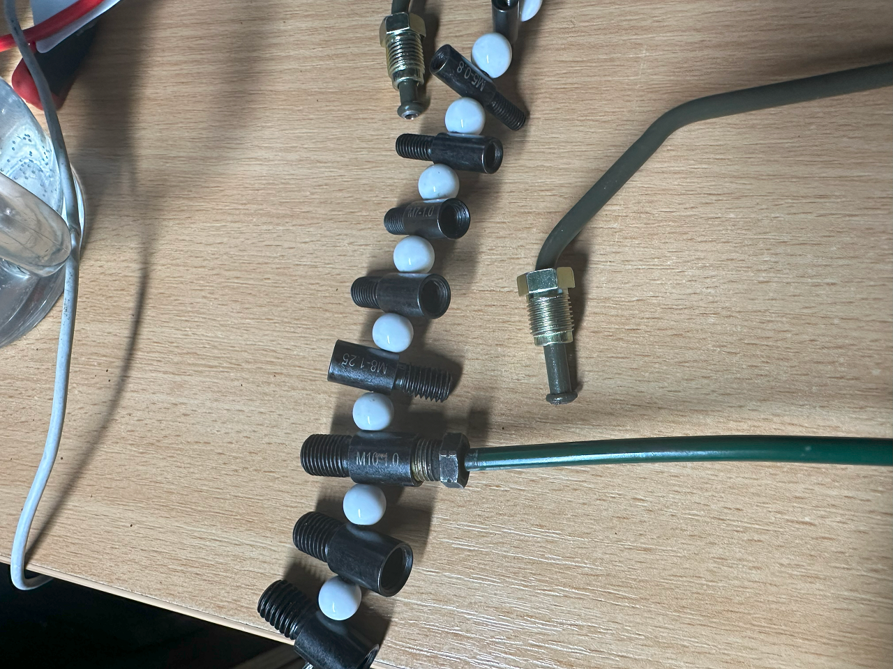

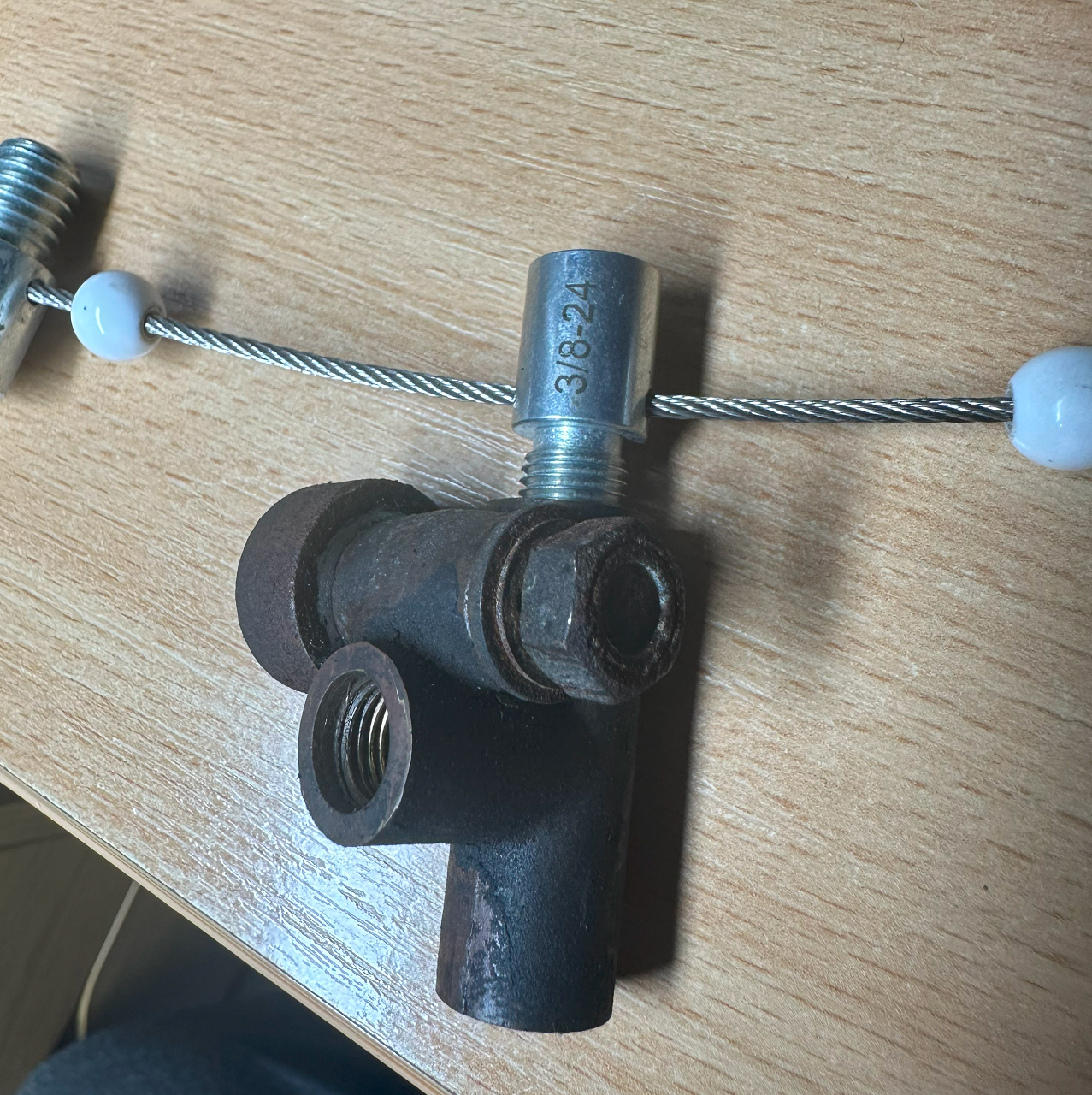

Was about to confirm exactly that - what a complete bear - so the real answer is - "it depends" - and you cannot be sure what has been or is fitted so I'd make sure to order some of both types - now I know why I ordered the 3/8"x24 tpi - so my original deletion was premature - I'm in the process of assembling my subframe so this post has been a useful reminder to go check my 'stuff' ....
The splitter
Old Bridge Pipe
Splitter pipes
