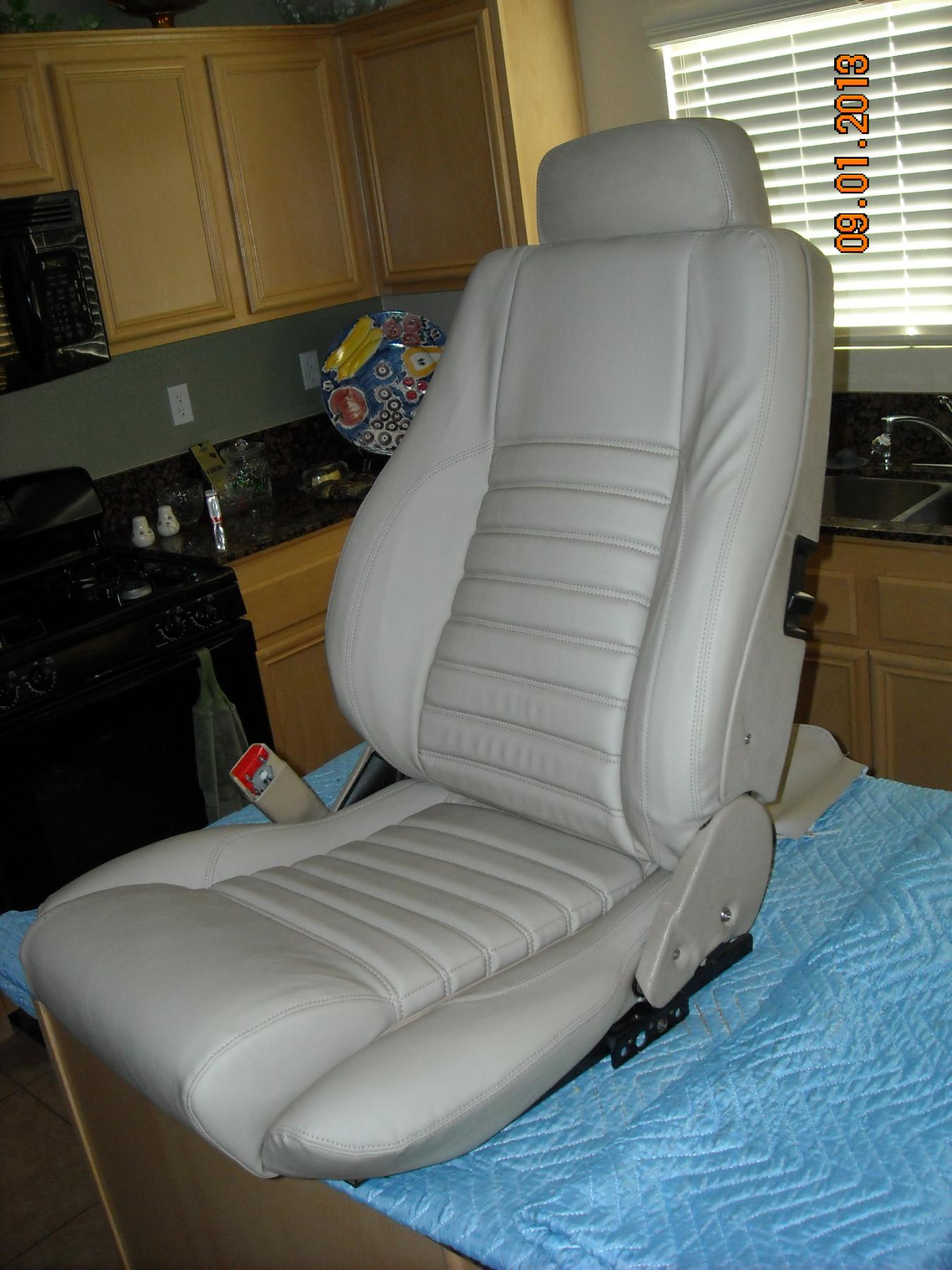

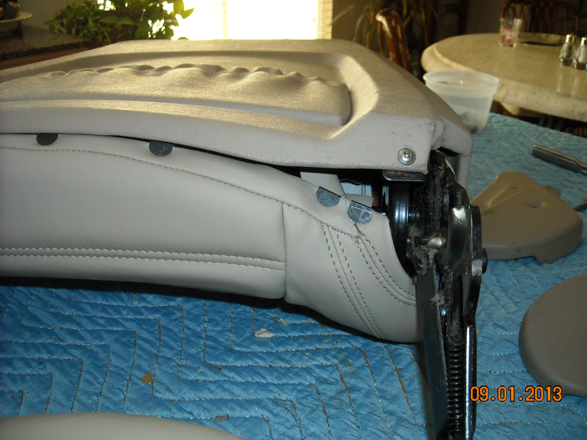

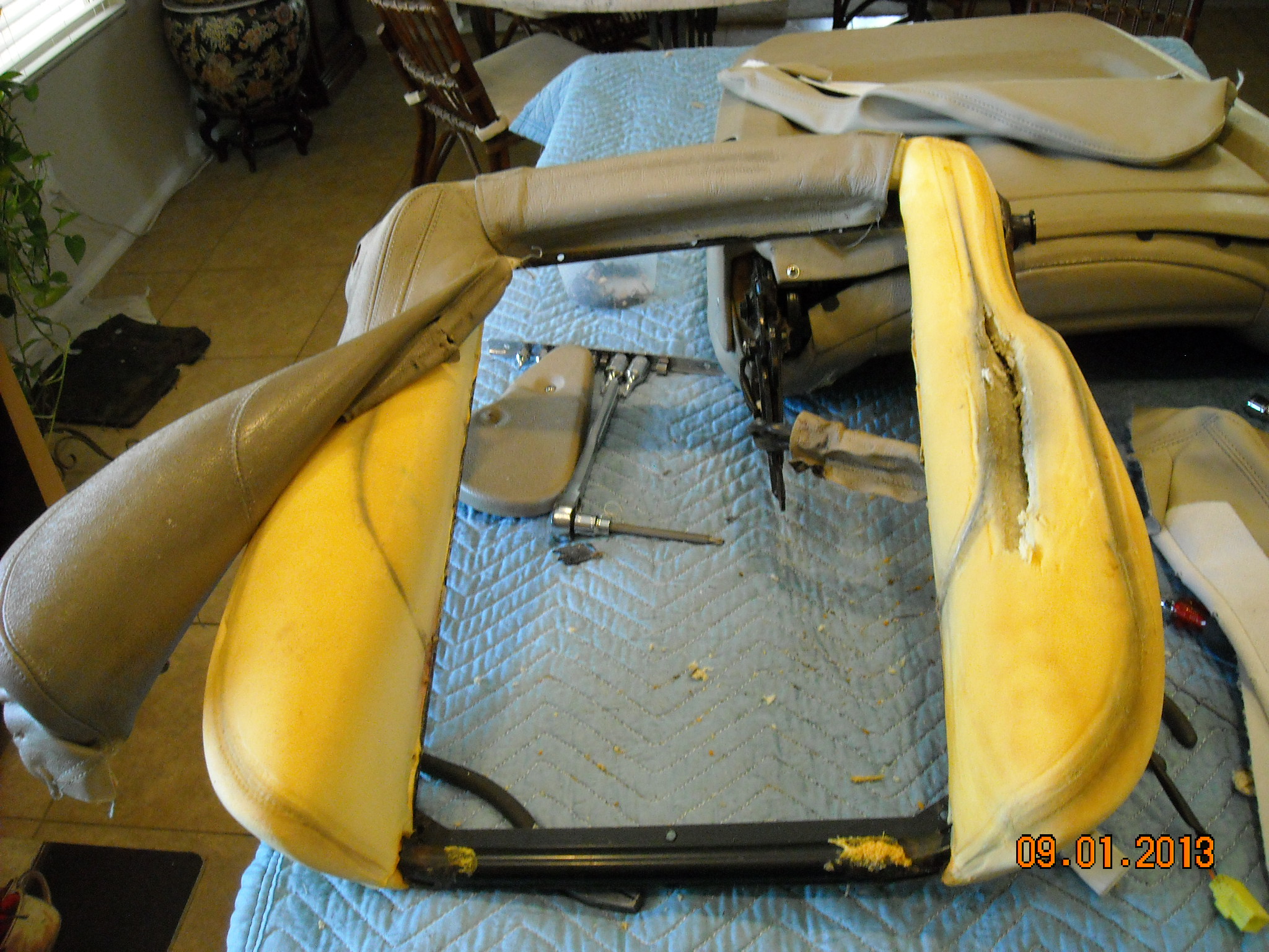

Completed replacing one seat cover on my fathers 94 XJS. The seat was getting ratty looking. The covers I bought were the vinyl type & I was surprised they look and feel like leather. Exact color match for the Doeskin interior color. Its a ton of work. Took 6 hours to remove the seat, remove the frame, remove the old leather covers & install the new ones. The bottom seat is in 3 sections. There's lots of clips & its a big project. Overall I'm really happy with the results. $310 including shipping for both seats. Ill replace the other once later this year. I including some photos showing the seat when I removed it & while we were working on it & when its completed. The wrinkles will come out with time.

I used the existing foam. Most of the foam was in great shape except for one of the lower bolsters that had a split in it-the one nearest the drivers door. I bought some foam at the hardware store & cut a long, thin piece and inserted it in & it worked fine. The other note if your going to do this yourself is the headrest can only be removed by taking the colored plastic backing plate off the back of the seat. Then you can access the hex bolt that holds the headrest in. There's a bunch of hog clips that have to be removed inside the seats... These things are thick wire and were tough to bend.

I cheated and used tie grips instead of the hog ties as tie grips are easier for me to work with. 2 years on my seats still look great.
