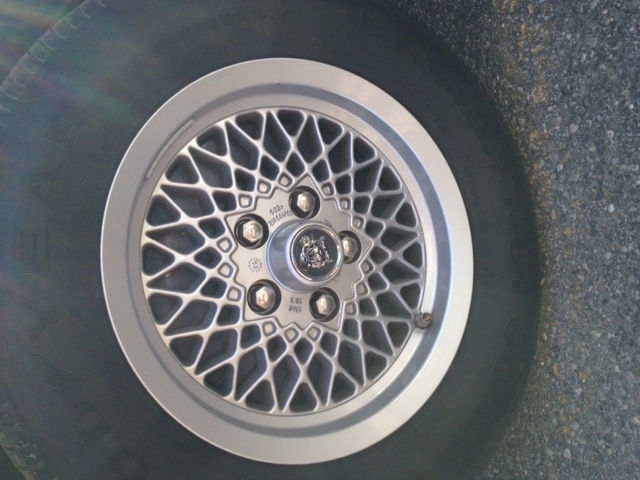

These are my rims. I was basically looking for the same rims but that are bigger. I am not trying to change the appearance of the car but I would love bigger wheels. What do you think? Any suggestions?
Attached Thumbnails Replacment Rims-%24-kgrhqzhjeke914i-ks-bpl-ovh9tg%7E%7E60_58.jpg

Those are commonly known as "Lattice" or "Sport Lattice" wheels.
Jaguar used them in 15x6.5", 16x7", and 16x8" sizes. The 16" variants, especially the 16x8, are rare.... but keep looking and you might get lucky.
I know of one XJS running the 17x8 wheels from a '95-97 XJR....looks good!

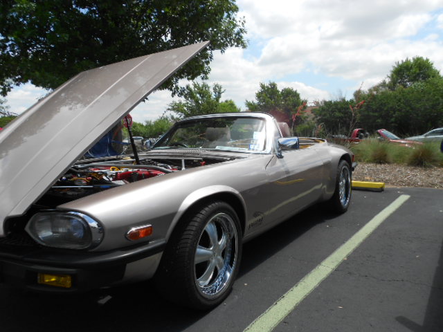

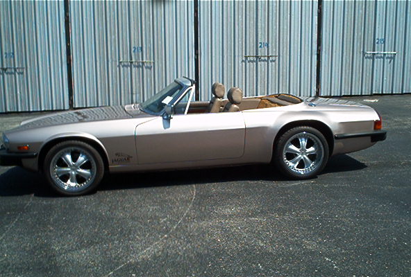

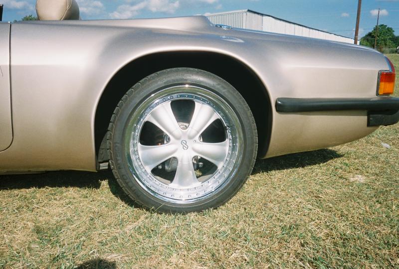

ENKEI ,, 18-9 frt, 18-10 rs. NITTO 275-18 all around,, spacers,, wide body rear arches.
no rubs,,( could be a little lower),, 16yrs and counting.
Attached Thumbnails Replacment Rims-jag-rodstr-001.jpg   Replacment Rims-jag-rodstr-003.jpg   Replacment Rims-r1-07368-021a.jpg

wheels are about,each his own idea, along with modded car, couple weeks back at car show(pic). BEST IN CLASS award plaque.
had a bunch of Jags, Ferrari, Audi,etc.
4 jag XJS, two converts,, 2 coupes ,ALL stock and nice cars, but kinda all the same(different colors).
anybody can BUY a ordinary car, few can buy a WELL DONE modded car.
Attached Thumbnails Replacment Rims-60.jpg   Replacment Rims-georgetown-show-plaque-001.jpg
