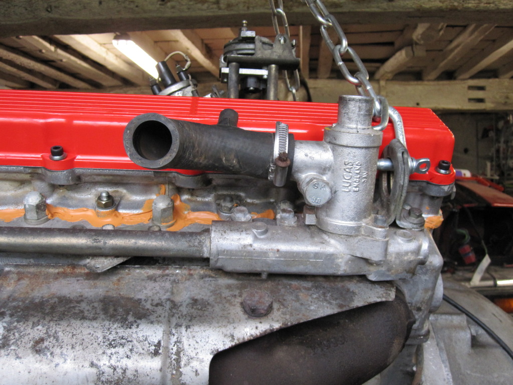

The Great Palm's book has loads about the AAV, here is a pic of it, B bank at the cabin end, the big bolt sticking out of it is the tickover adjustment.
You can unbolt the thing once the aircleaner is off, and probably free it off with a bit of careful work, penetrating oil etc, if it is not too far gone.
