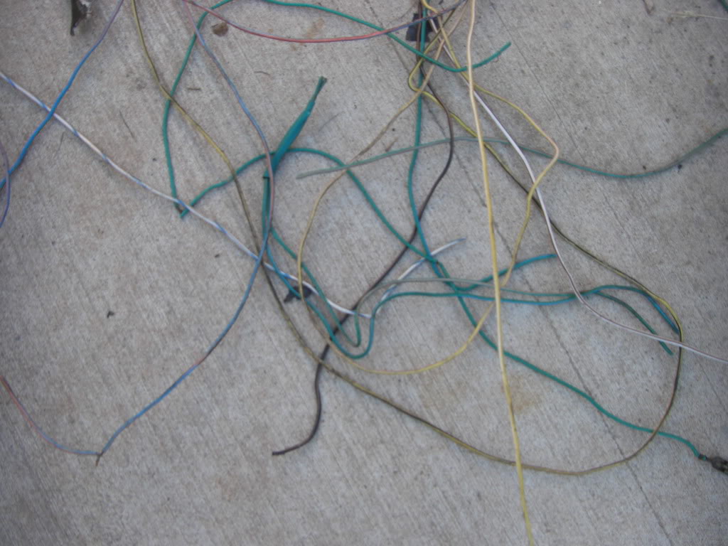

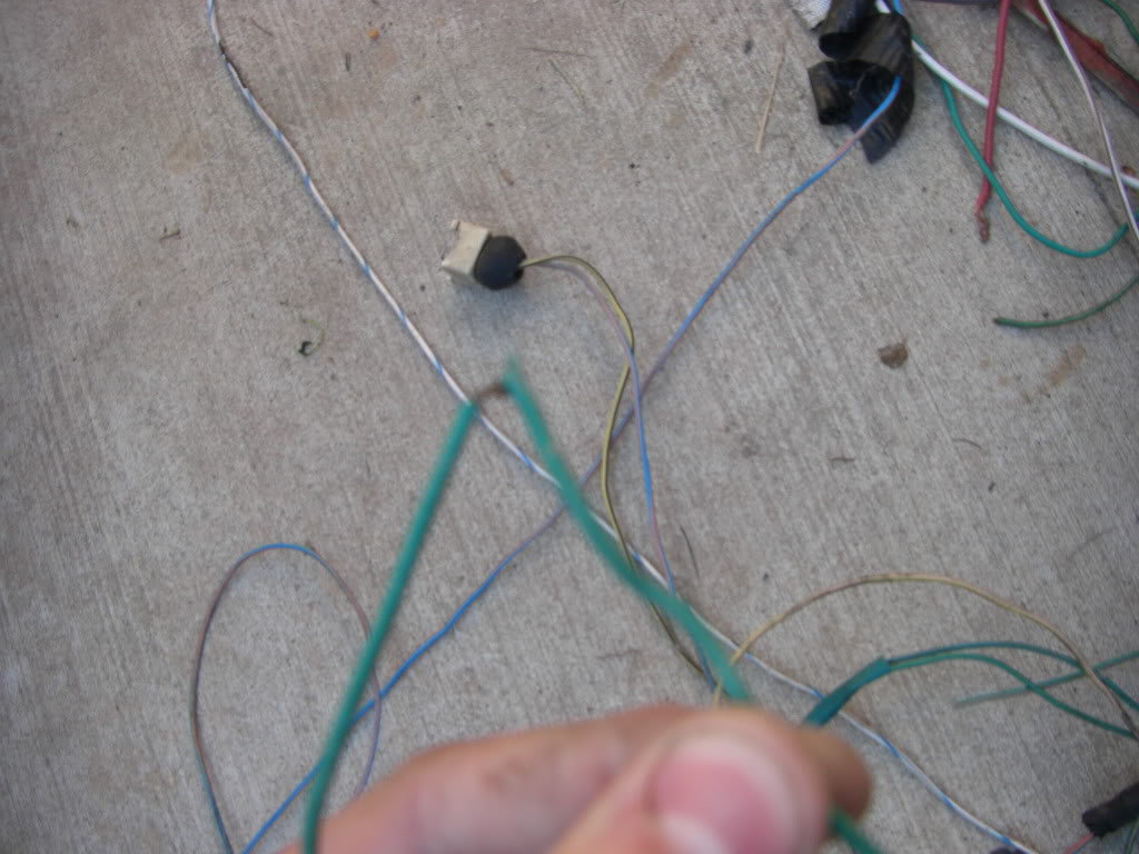

Heres the NUMBER 1 reason you should keep your XJS cool.
theres aboiut 50x more where that came from.
/thread.
