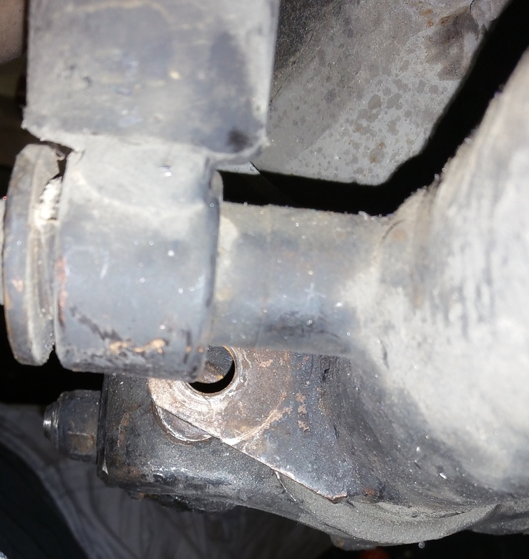

I didn't notice until I was down there that it actually appears to be a hex head bolt with two of the sides ground flat. Is this true? I'm assuming that this is so that it will clear the coilover mount for installation or something of the sort.

the bolt head has a special shape to pass the rear shock mount, if you look at the rear shock mount you will see a bolt , then the shock bush , then a shim of about half an inch
this needs to come off to allow the radius arm bolt to easily be installed, with the lower swing arm at its lowest, the spring/damper assembly should come out without it extending or putting force on the lower bolt holding it, the damper will then move out of the way slightly
the special bolt for the radius arm will need a spanner to install avoiding the special shaped side
its a PITA but well worth the effort

Thanks for the tips, BB. I hope to give it a try tonight or tomorrow. So the damper/shock/spring assembly should come off of that bolt without needing any kind of compressor or anything to put it back on once the bolt for the radius arm is installed?

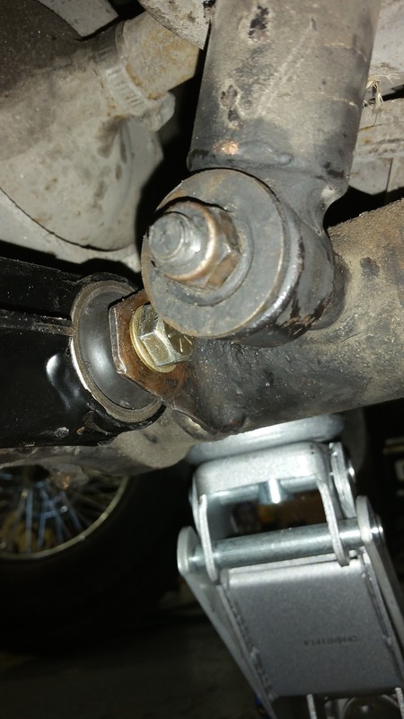

I ordered the special bolt with the flat with SNG but when I got to thinking about it, I didn't want to wait that long for it and it's just a bolt with a flat on it, right? So I made my own. I got a 2.75" long 1/2-20 Grade 8 bolt and sanded two of the flats off on a belt sander. (Grade 8 is what we had at work, I would have gotten a Grade 5 if I were purchasing it on my own because they have a little better shear strength, but beggars can't be choosers.)
Just like everyone here said, I moved the jack from the lower suspension arm to let the assembly come to rest. It still has to be jacked up of course, though, so I put a jack stand under the diff cover (where it says to jack from in the manual if you want both wheels off the ground) and put a jack stand on the side for stability and my own piece of mind. I was then able to undo the shock tower nut and washer that were in the way, and I actually just slid the shock mount and spacer over a bit and was able to get the bolt in. I didn't have to actually remove them at all. My assembly was dirty enough that by just looking at it I couldn't tell that there was a spacer there at all.

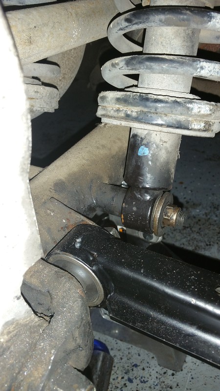

Bolt installed:
There was exactly zero clearance to get that bolt in. I see now when installing it (had to cut the bolt head and the bushing in pieces to remove it) that it actually rubs the shock tower mount, I had to tap it in with a hammer. It went in easy though and threaded right in. I got it snug, moved the jack back to the arm to bring the assembly back up to ride height (ish) and tightened the bolt (and metal bracket) on the front of the arm. Then I lowered the car back down and removed the jack entirely, tightened up the 1/2-20 bolt, and took her for a test drive. Everything works great now, and it's nice to have that old, rusted out radius arm off of the car.
