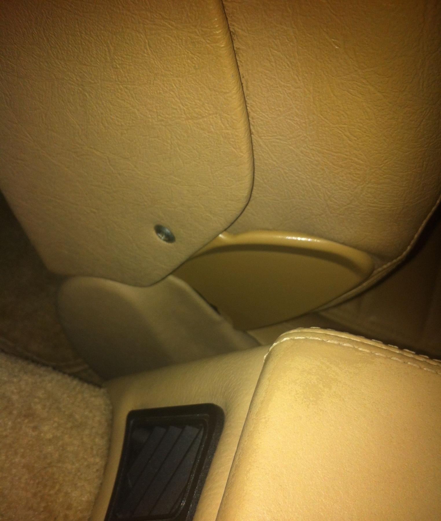

Can anyone tell me how this seatbelt deflector is supposed to go on a 95 drivers side seat? I just got it and have no idea how to install it it's number 15 on the picture::

Do you not have to take your existing one off?
I had to replace my passenger side one last year as it had cracked (common ailment). You have to remove the squab cover and then slide in the deflector. The squab cover side screw then goes through the deflector when you re-install it.

Thanks a lot!!!
The original must have gotten lost when I got the new leather installed :-(
I thought the deflector went on the other side by he handbrake. No wonder I was having problems
