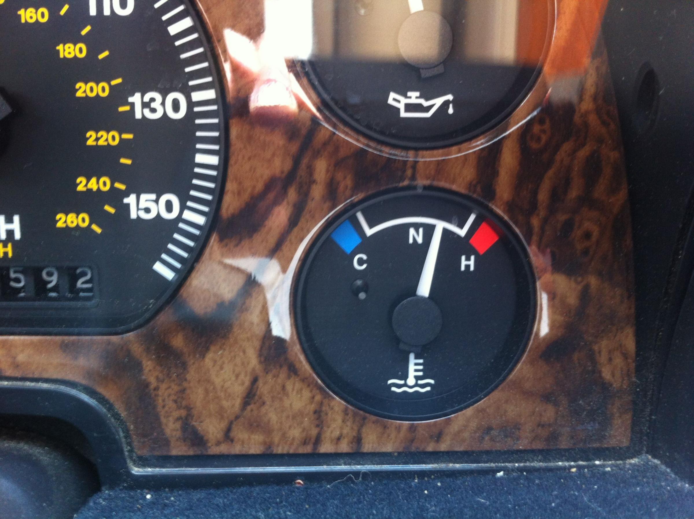

Unless you have modified the circuit, the electric fan is independent of the A/C system. It is only controlled by the thermal switch in the radiator. The switch is supposed to go off at 91C and on at 96C. Because of it's location about 1/3 of the way from the top of the radiator, coolant temps exiting the thermostat are about 100-103C before the fan switches on, this will show as about halfway between N and H on the gauge, however this is still in the 'normal' range as far as Jaguar are concerned. This pic shows my gauge just before my fan comes on.
