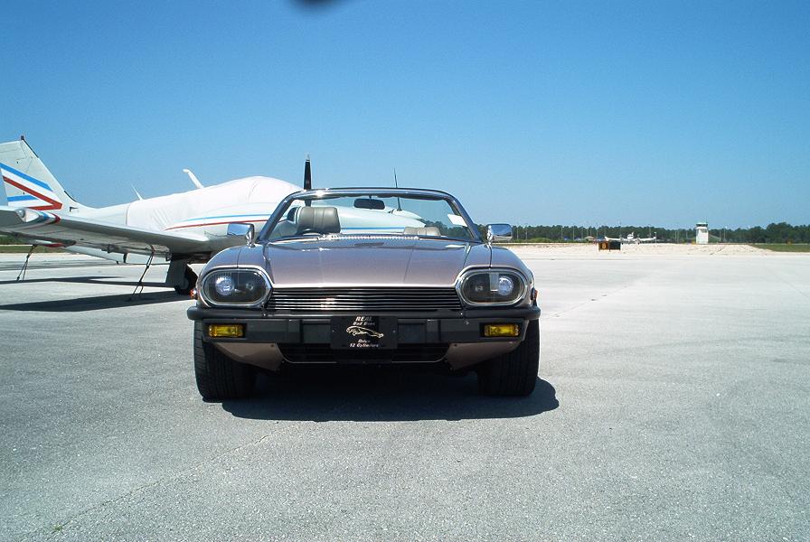

well seein as you are in Texas, im in Austin, quick pic of car for sale.
100% restored!
