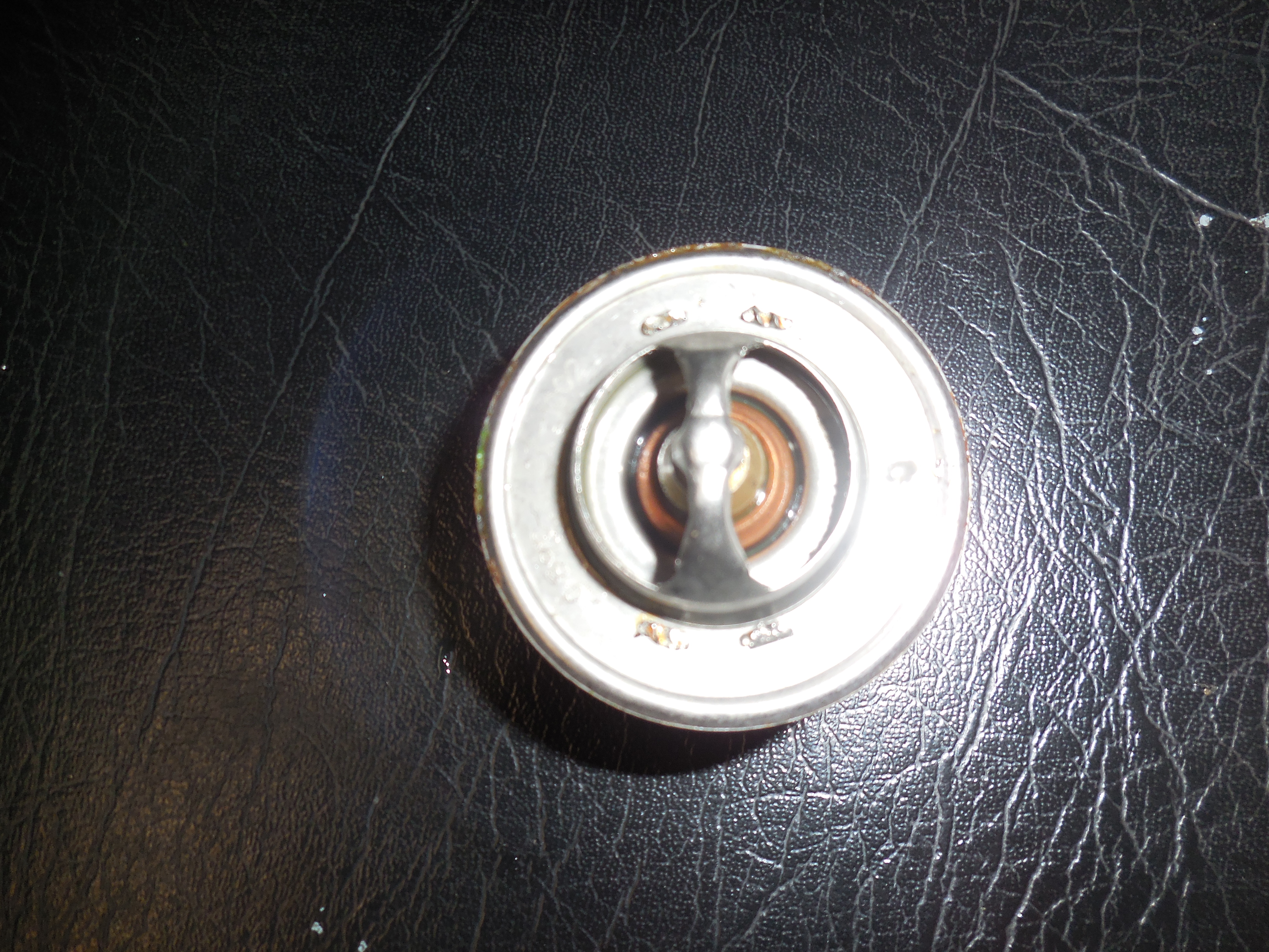

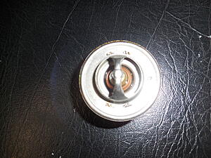

It did have ststs and I can see the jiggle pin.
89C = 192.2 * I think I want a 160 0r 180

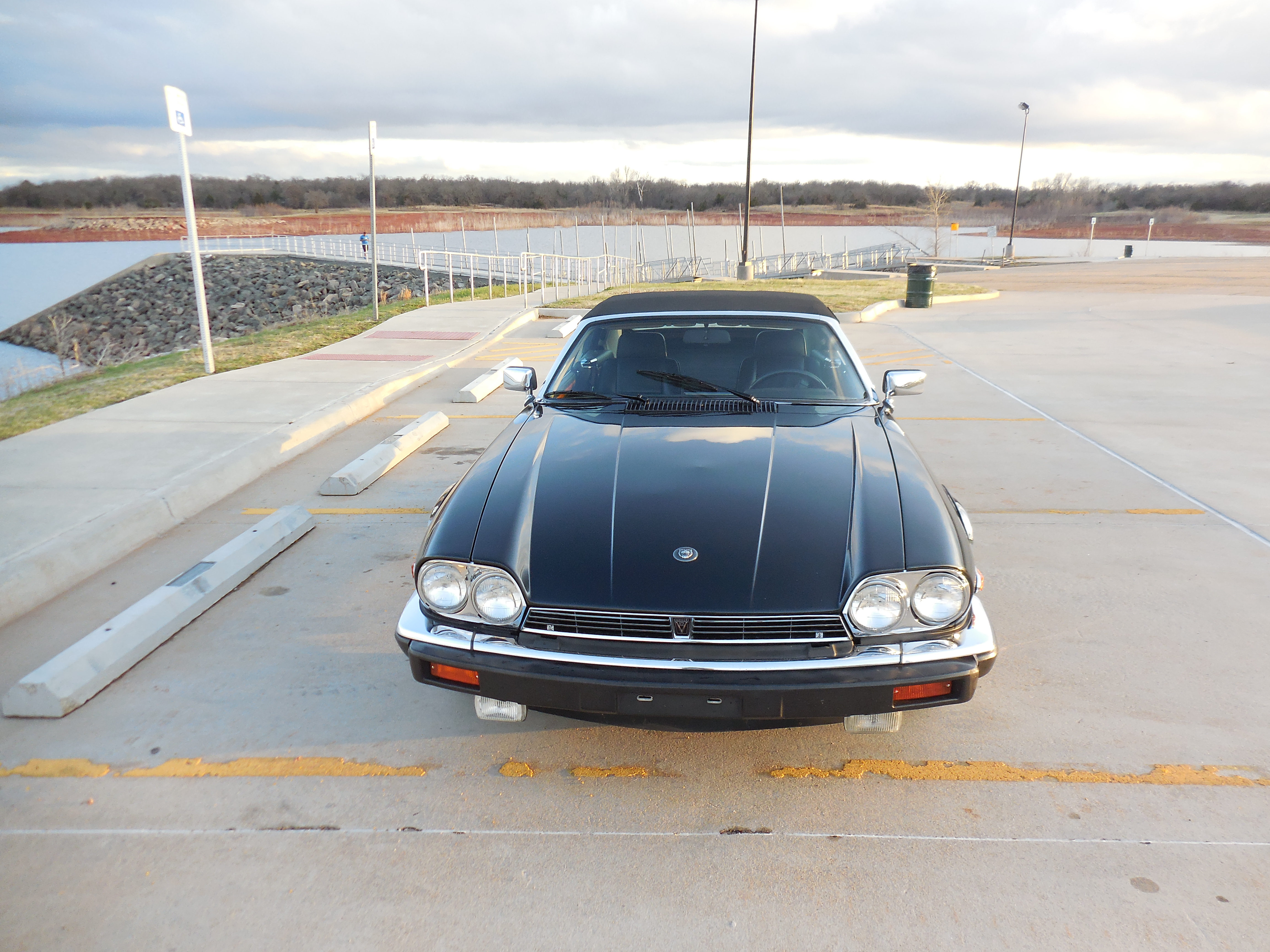

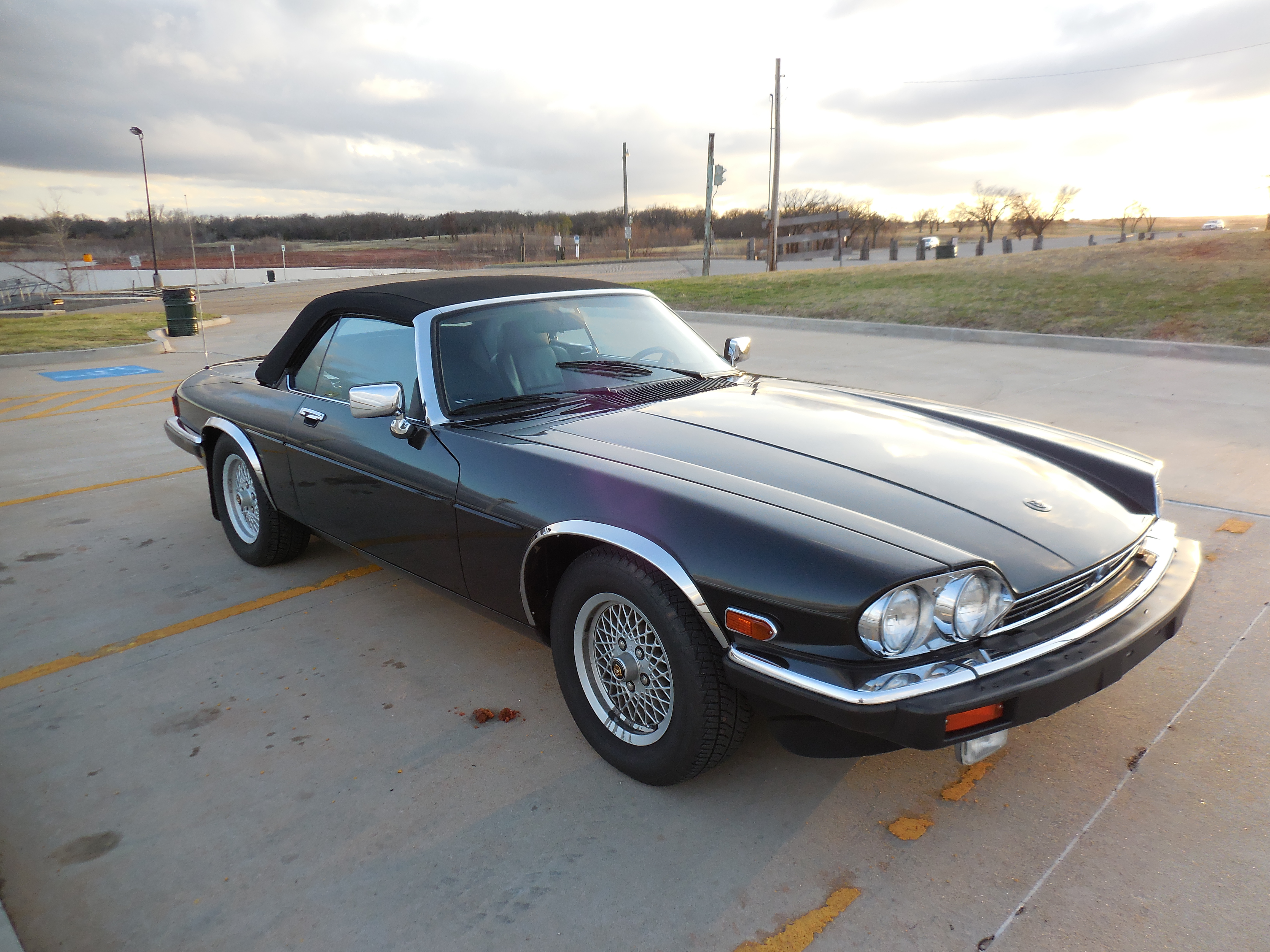

@macdoesit, do you have a picture thread here? Don't see too many triple black convertibles - I think I want one.

Very nice macdoesit. Got any with the top down so we can see exterior and interior at the same time?
