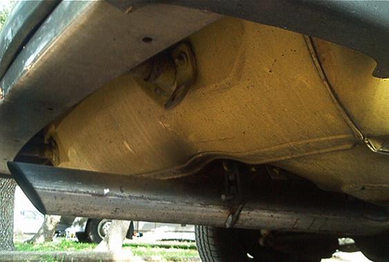

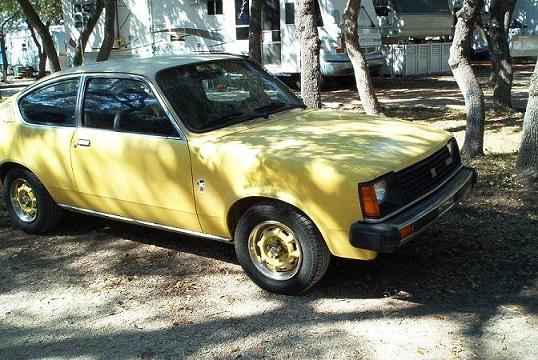

Old Sep 1, 2013 | 05:20 PM
  #107
ronbros's Avatar
Joined: Jul 2010
Posts: 7,362
Likes: 1,241
jamey, google remote turbo systems, STS is a good company, they can sell you parts to make a simple twin turb. setup,remote mount its just pipes running back and forth, much simpler and CHEAPER than any other forced induction system.
good idea to use some small turbos from 4cyl. car, dont forget you are not going to build a *****-out super-duper go-fast engine, you should be just wanting,say 5-10 psig at full throttle, cruise will register a vacuum(good for mpg). for a stock used engine, i'm sure it will work, been there,done that.
most of what talk I about is REAL, not all types of numbers and theory ideas, with no actual hands on experience.
you will need gages, for manifold readings of boost and vac., fuel pressure at full boost.
all basic simple stuff, R&D turbo related sites on line, there must be hundreds out there now a days.
i been doing turbo cars & trucks since 1979, and the cheapest way for regular street car is rear remotes.
pic of my Opel diesel turbo setup, works great and has reasonable power without blowing it up, better mpg ,done it back in 2007!
sorry dont have many pix of others i have done!
