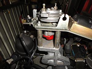

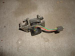

For comparison here are side by side installations of the red and black TPS
Attached Thumbnails so what to do-no one has a tps switch?-black-type-tps.jpg   so what to do-no one has a tps switch?-red-throttle-position-sensor.jpg
