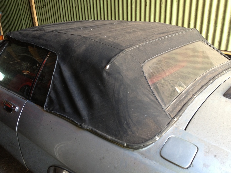

Here is a picture of the soft-top. This soft-top does not fold down as much as a H&E soft-top. But there is a fabric cover to put over when folded down.
And there's a back seat in this car! The back seat is not modified, but the side panels are a bit wider to make room for the mechanics. I'll post more pictures when i get this cat home.
