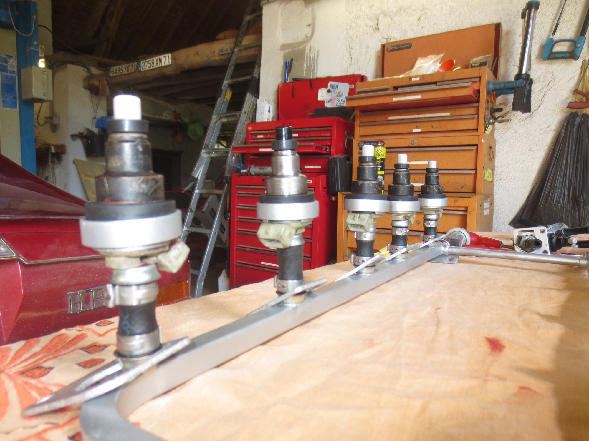

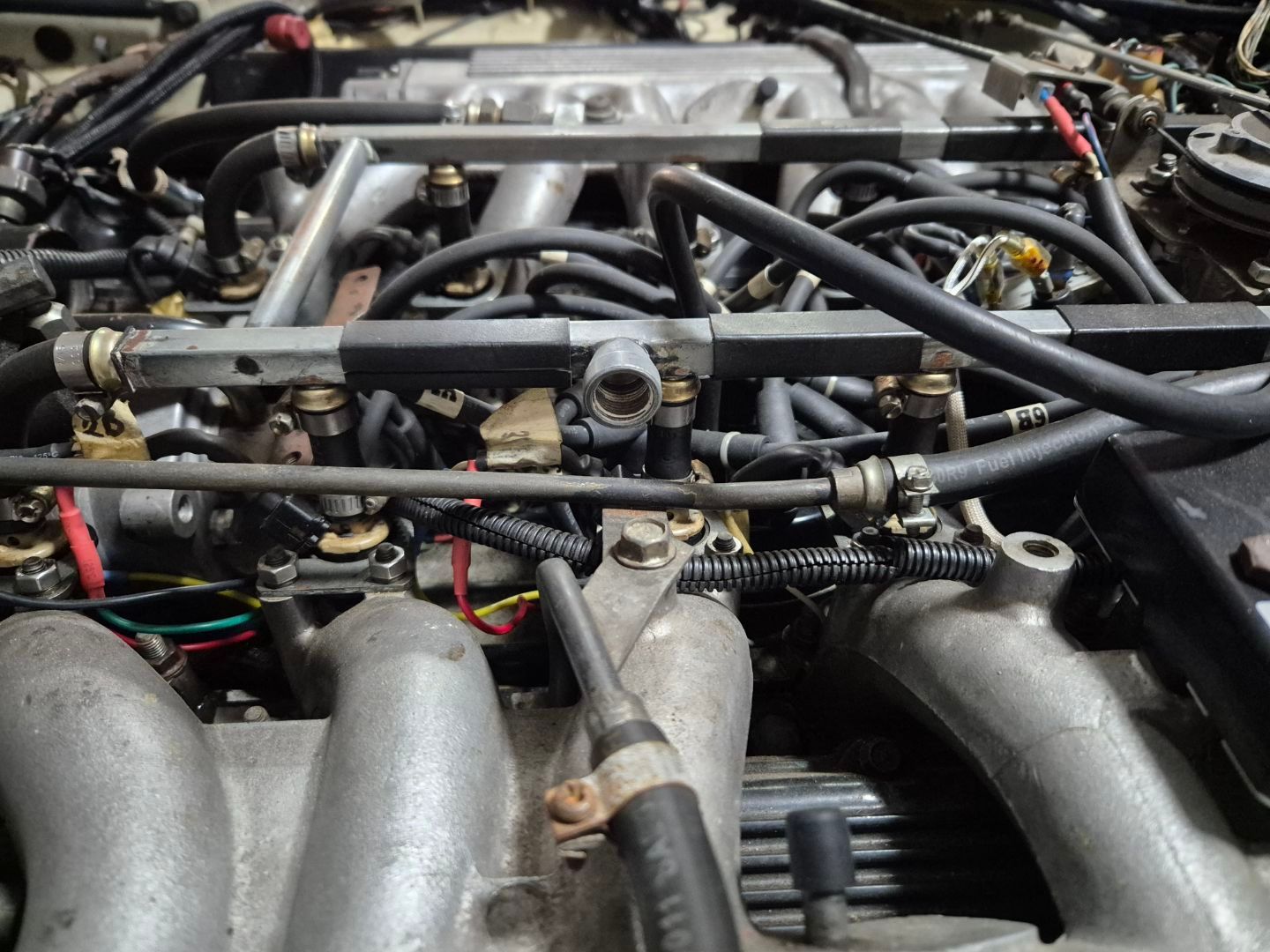

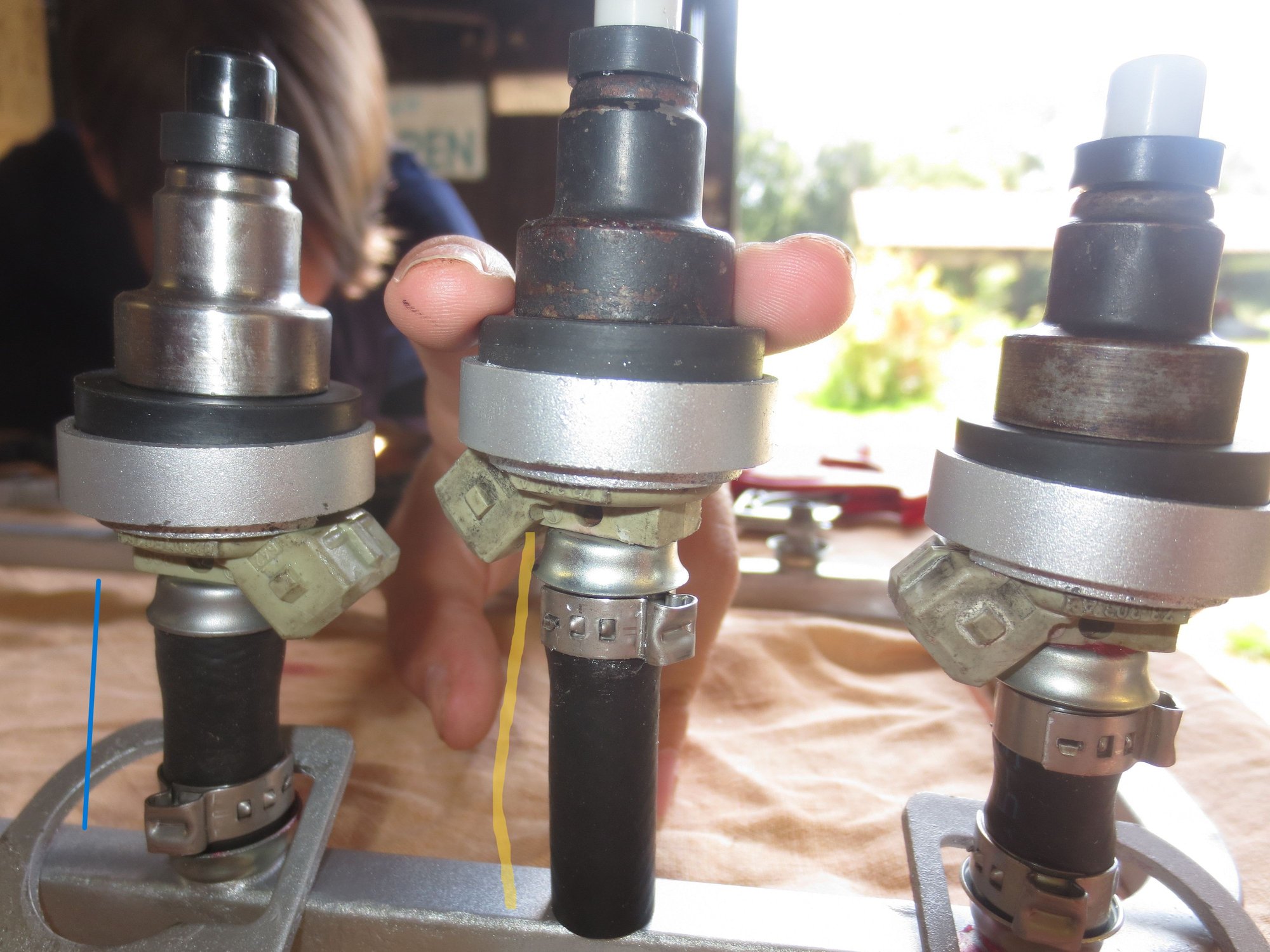

I believe insulating the tubes down from the rail to the injectors would be a mistake, as once they are hot the insulation will be hot and so that will be even worse than standard.
My view (as yet untested but it chimes with Grant's post just above) is that shortening the rubber tubes between the rail and the injectors will help considerably, as then cool fuel on cranking has a far smaller volume of hot/vapourised fuel to get rid of before proper cool fuel arrives and the engine fires. I have just rebuilt my injector set with shortened tubes and am in the process of making a new silicone-insulated-wire injector loom which will be impervious to heat and thus should permanently cure the injector loom failure mode on the engine.
Showing the difference between OEM length and shortended length.
The entire A bank row of shortened injector tubes.

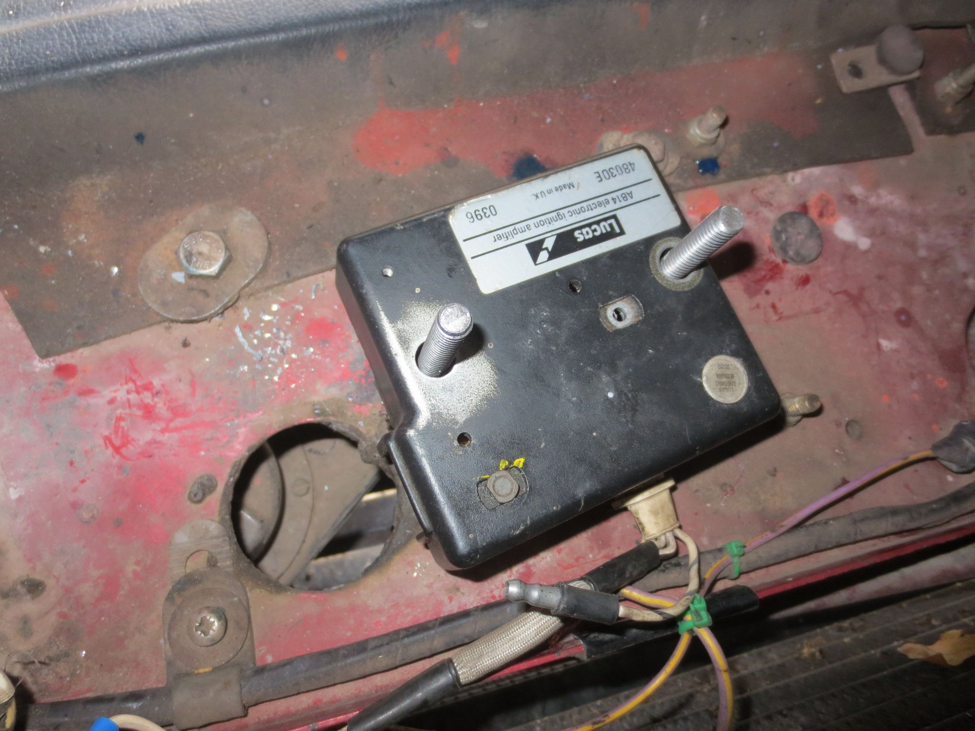

One I was dealing with recently by remote, had issues like this. It took me ages to convince him that this 12.5:1 engine needs a Fat Blue Cracker spark to even fart. He had the rail down, better, and then he finally fitted a relay to the coil Pos wire, and all sorted. The Ignition switch refurb was done after that.
ALSO
My Fossil brain forgets ***** at times.

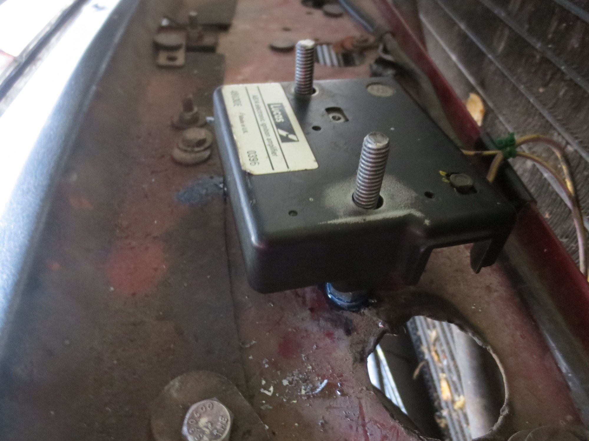

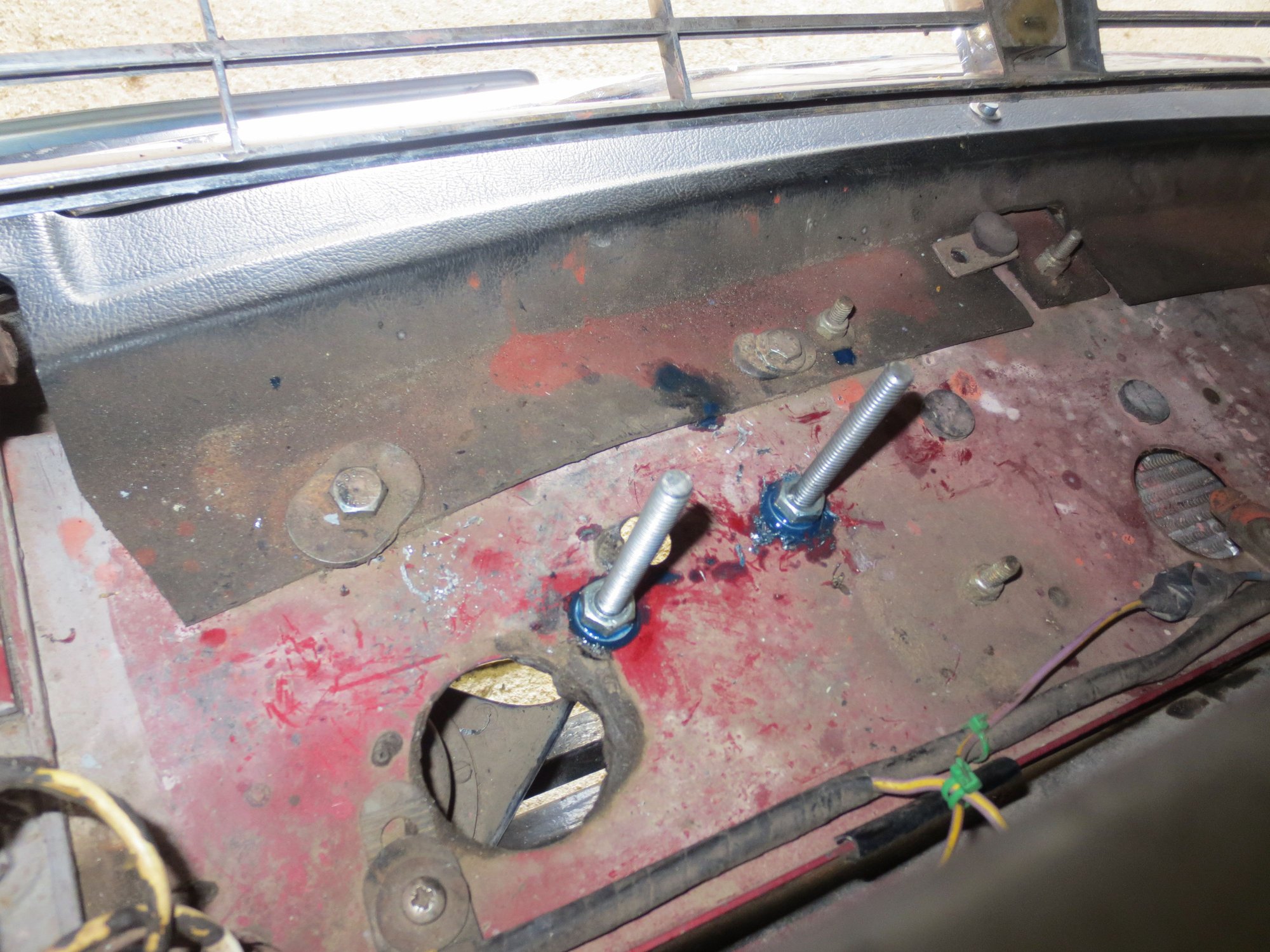

I moved the Ign Amp out the front, RH side of that valance, and simply ran wires to suit, and NO shielded wire until the bulkhead connector. Those wires ran up the underside of the drain channel. Heated AB14 is not a happy AB14. Also removed that condensor thing inside the AB14, not needed, and they leak to earth and upset spark.
Old Apr 23, 2026 | 10:55 AM
Greg in France's Avatar
Posts: 14,607
Likes: 10,802
From: France
It looks like you have shortened the flexibles to the rail. have you still got a hot start problem?

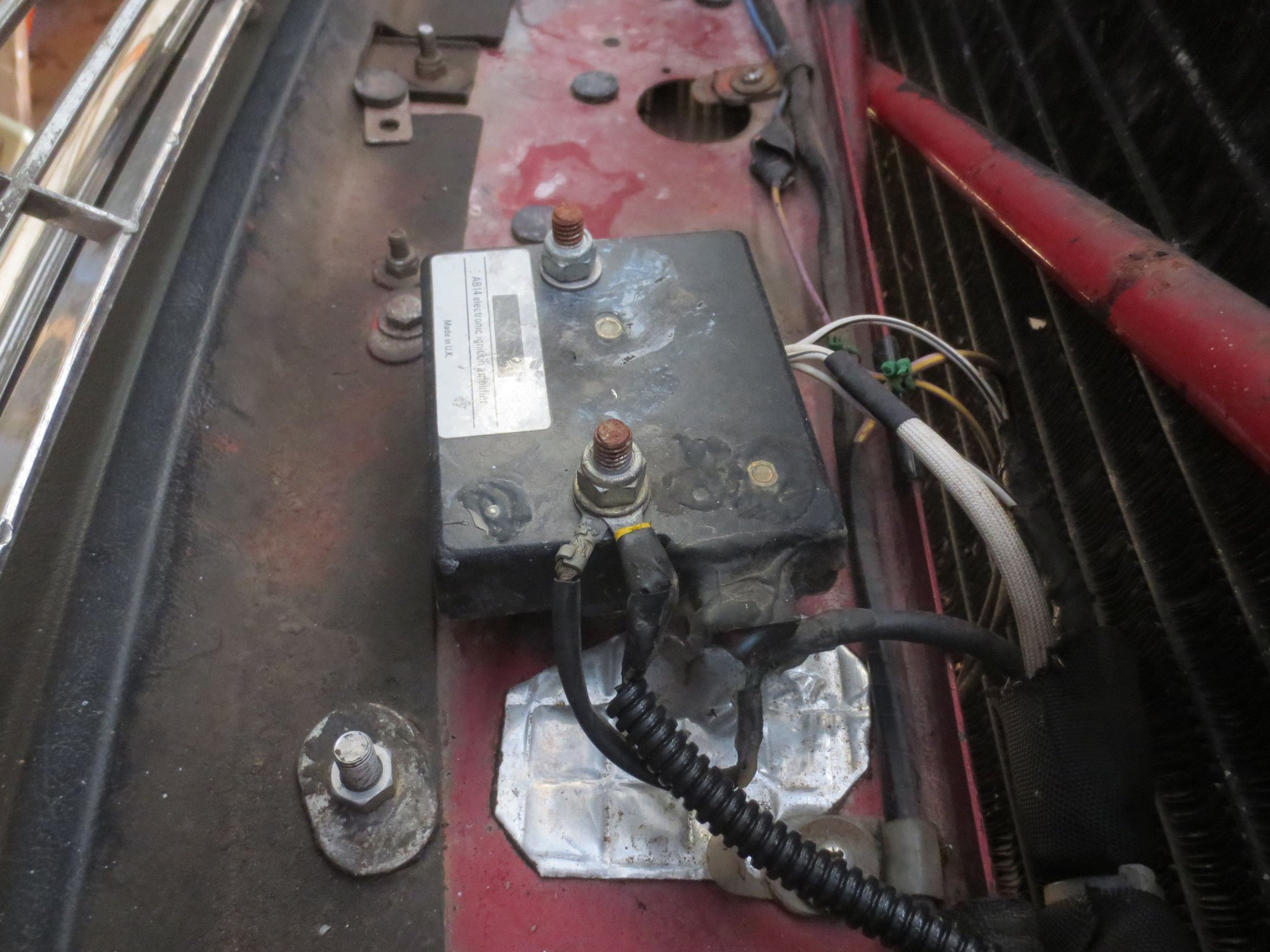

Forget the hot start thingy, it does sod-all. If you have the shortened flexibles, renew the coils, HT leads, plugs, dizzy cap and rotor, and amplifier out the front (carefully waterproofed with gunk round the casing shutlines) as Grant says, and a relay to the coil 12v triggered by the normal 12v coil feed will do it. Also check the B bank FPR is spot on and not old.
My amp out front:
Mounted on stilts so the air gets all round it
earth wire to LHS rad crossmember earth bolt. All the coil/tacho/dizzy signal wires run to the engine using ordinary wires in wrap.
