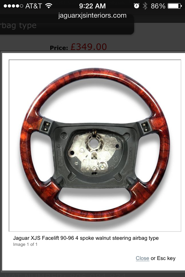

Please do take pictures. This has been on my wish list for a long time now:
Another member, Luvmyxjs, has one on one his cars. That sold me, I must have one!

I fitted an airbag steering wheel in my '92 MY convert. (mine didn't have one in Europe). Bought a walnut one from a UK company £340.00 ish. I then had to get an airbag, (£100.00) 76 to 46 spline adapter from an XJ40 (Ebay) and the airbag firing pin (doesn't come with wheel )!! and swop out the horn buttons. Also made up the "special tool" ...drilled a 5mm hole into a bolt, smashed one side with a hammer to make the hole look like a 'D' and Bobs your uncle the pin turns, don't forget the small grubscrew locking the pin.
I believe that the US airbag is bigger (typical...ha ! so wont fit a European wheel, so ask if they have a US spec. one.
Also seems that swopping to a later Jag wheel you might need the adapter as the splines may be as mine, smaller. I think that the '95 wont need this.
