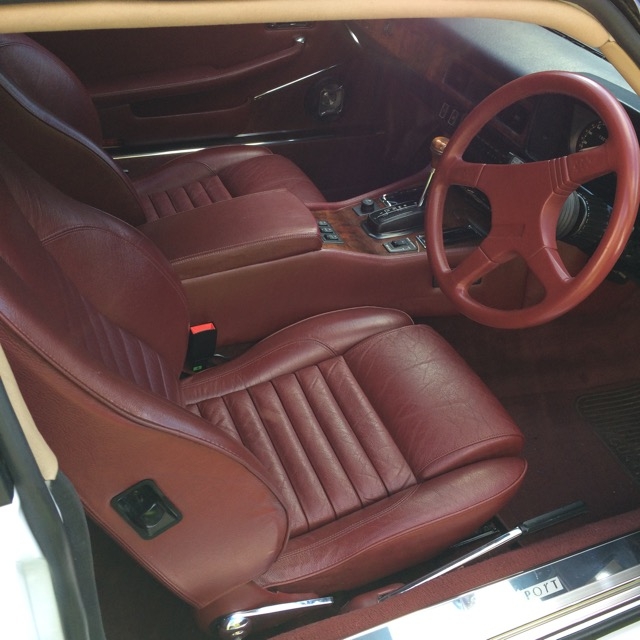

the steering wheel is a genuine item , though could have been retrofitted by a PO any time isn the cars history , and is not an airbag.
the gear knob is however not a genuine jaguar item , the shape is all wrong ,
however,
the fact your shifter stick has a threaded top is significant, as all other XJS's had the toggle top selector, and only jaguarsport/TWR cars received the threaded selector
my steering wheel and selector knob from my January 1989 car ( UK ) , but has a different centre section with no inlay ( just a ' sport ' section )
IMG_2993 by MyPix on Talk Photography
a correct selector knob ( in wood ) for a 1989 car , however, most were colour coded leather covered of a similar design
833 by MyPix on Talk Photography
any new owner could cherry pick any or all of the ' enhanced ' options at time of ordering, a simple body kit to full engine enhancements , to a sunroof or simply a rear spoiler, the choice was yours, so this doesn't make any ( or your ) car wrong, just personal specification at the time of purchase
but as i said above, these items are easily swapped or added in a few minutes by anyone
got any more pics of the car
BB
