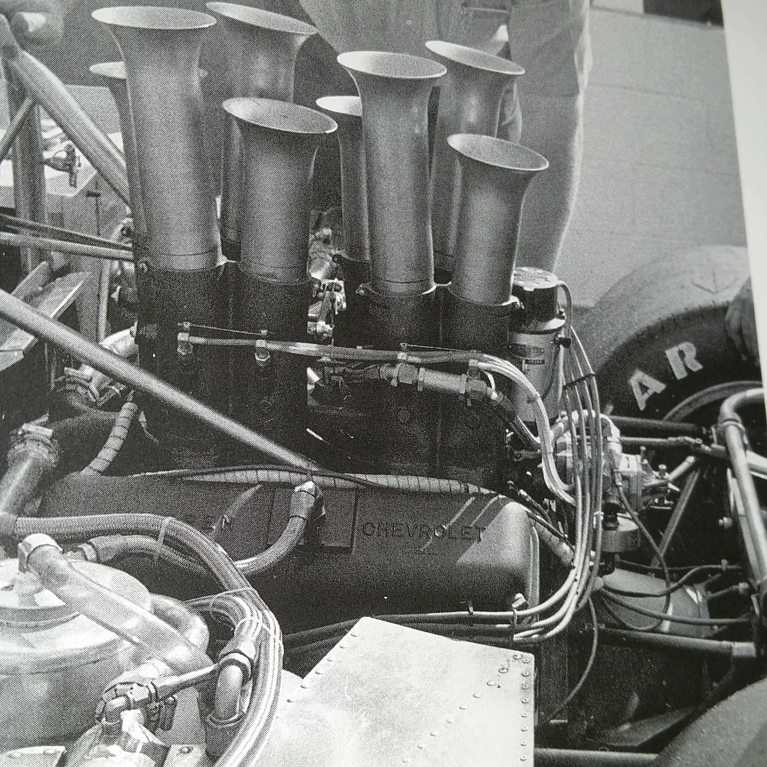

pic of Chevrolet engine BBC, making around 900HP, NO turbo's,, year 1968, these cars were faster than F1 Grandprix cars of that era!
you young guys have no idea what 20 of those BBC open exhaust , sound like coming onto the 1st corner straight, at full throttle
most were banned because they were to FAST, suspension and brakes were not good enough,, lot of guys were killed, so rules were made 1969.
then Porsche figured out how to Turbo there Flat twelves, 1500HP!
YUP that was the end of that crap racing!
