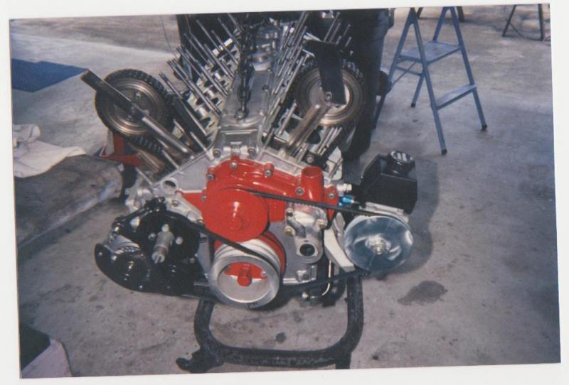

and when you finally got everything done on body and suspension, PIX, you can do the engine,, P/S pump is from a Dodge Viper, only 3.5lbs.
and if you guys get really lucky, you may find some VERY rare raised port cylinder heads ,you can tell because they around 3/4" higher or thicker, big improvment in exhaust port flow lines.
