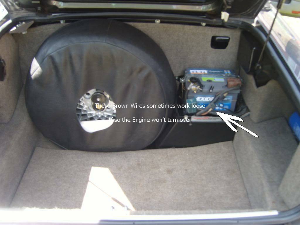

If you have a look in the Boot/Trunk, where the Leads go on the Battery.
You can see a couple of brown wires that push into a connection on one of those Battery Leads.
It is very easy for those push in wires to get dislodged, the only problem being that it isn't immediately obvious just by looking at it.
In the event they have worked loose, the Engine won't turn over though sometimes it might do so, depending how loose they've become.
If you jiggle them about or better still give them a clean, then I've got a feeling that this might solve the problem.

Hmmm.... very interesting..... I changed the battery a few weeks ago. (and of course that means fiddling with a fore mentioned cables) Guess what I'm going to go check immediately......

I inspected, cleaned and reassembled the connector you mentioned. The car was starting fine before and after (of course it was) so at this point its not conclusive, but it was good preventive maintenance anyway.

That connection, can also affect the lights on the dash in the way you described.
The trouble is the Battery lead is too stiff to jiggle about but it still looks to me like the problem may be in that area.
That's where it was on mine, turn the key and no lights!
Jiggled the wires on the Battery in the Boot/Trunk.
Turned the key, lights came on and then the engine turned over and She Started and has done ever since.
Might be an idea to also look at the block connection just above it.
