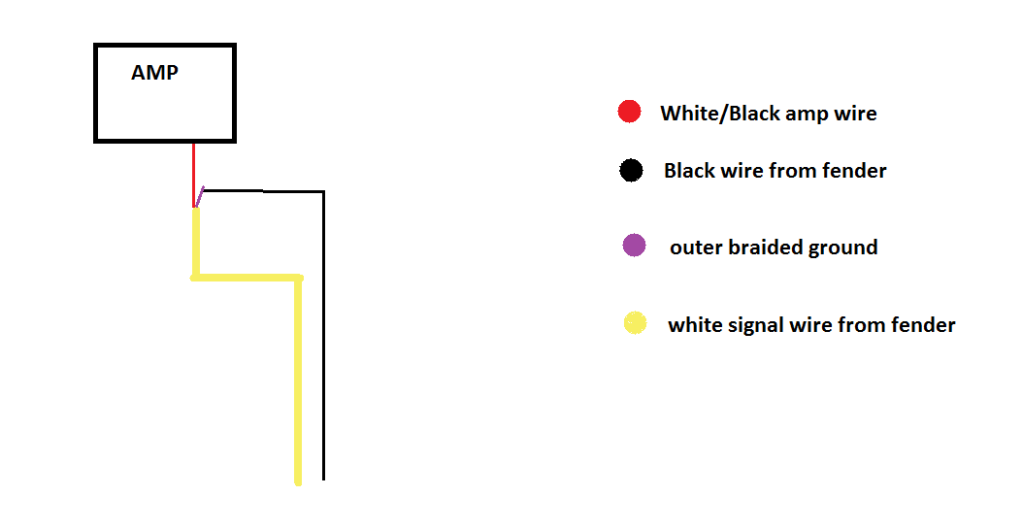

my amp signal wire has had a botched repair at some point. looks like a kindergartener did it with string and electrical tape.
here is how it is currently wired.
if this is incorrect, please show me how it ought to be wired.

Yes, that looks correct, but if the wires have poor connections it will pick up interference from the surrounding wires.

Also the shield should be grounded at ONE end ONLY. Grounding at both ends can cause interferance in the sheild which will be transmitted to the internal conductor.
