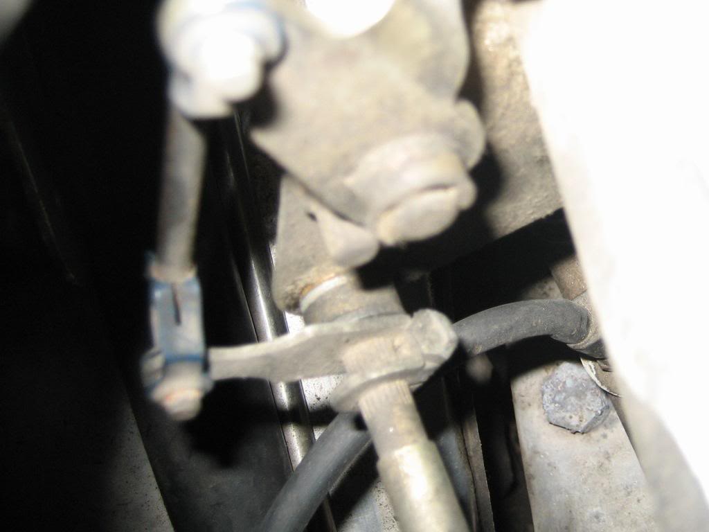

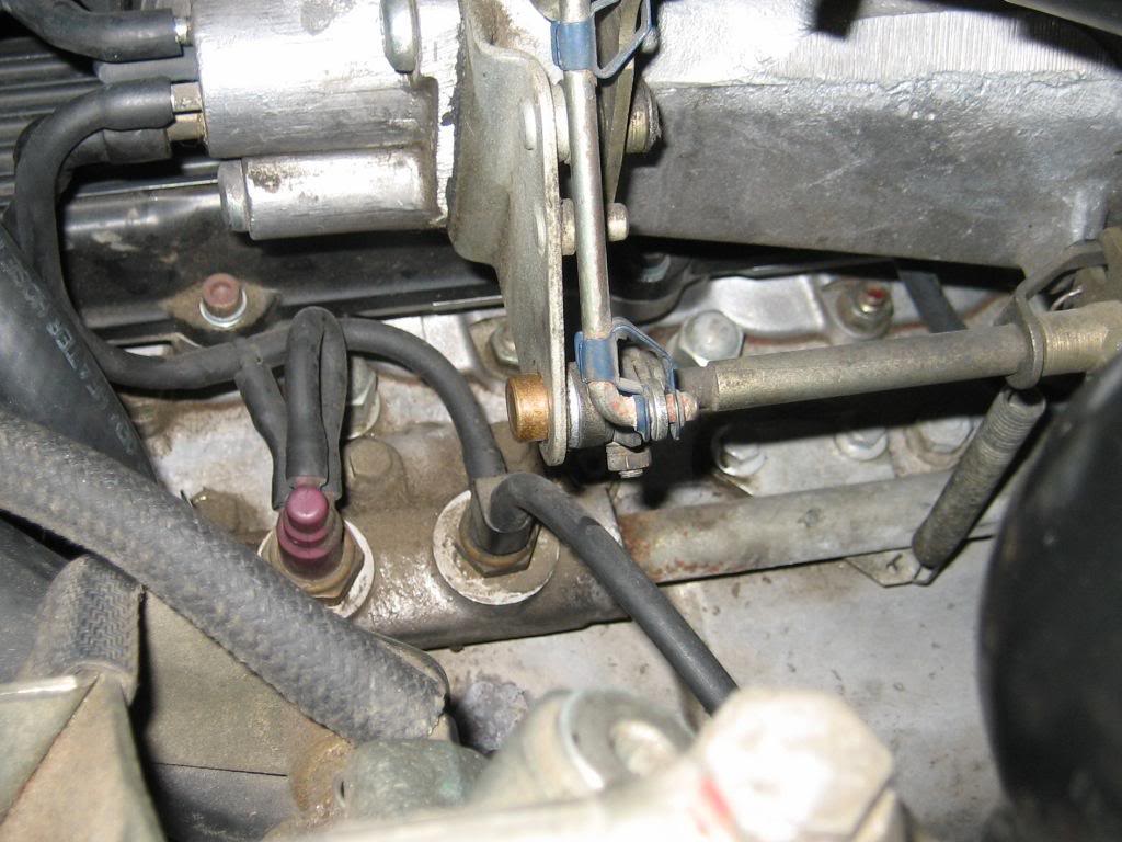

I hope I'm talking about the same bushing, and I don't end up looking like an idiot. I went to O'Reilly's and got a replacement brass door hinge bushing assortment from their "Help" rack. There is a pair of bushings in the package that are a perfect fit and guaranteed not to wear out in my lifetime

No, I didn't but they shouldn't be hard to find. I think there are only one or two different packages of door hinge bushings offered. Look for the assortment with brass bushings with collars. They're the same size and shape as the original rubber pieces. Perfect fit, no alterations required. I'll try to post a picture later today.
You can see the brass bushing in the photos below. I tried to get a shot of the bushing collar on the forward edge, but it doesn't show very well. If you slide the bushings in from the front, they're captured by the linkage and bracket and can't fall out. Pretty slick.
