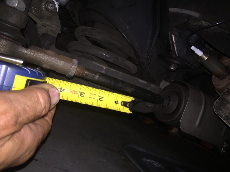

Here's mine, 1/2" on the left and 3/4" on the right.

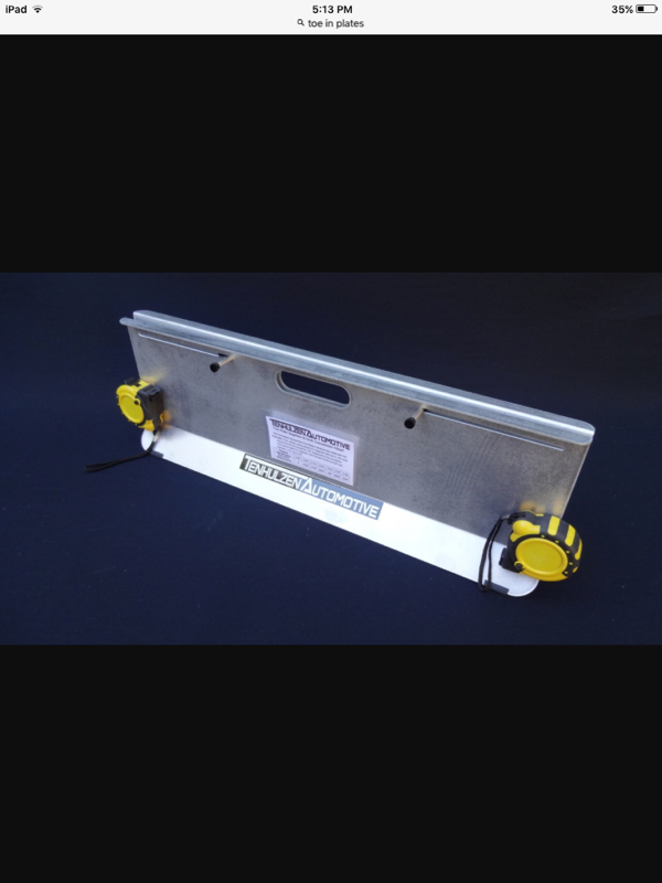

I bought this set off eBay for $80, I like them over others because they take the measurement off the wheel not the tire, I've used them on my TR6, XJS, XJR and sons suspension rebuild on his e46. Well worth the $ and really come in handy.
