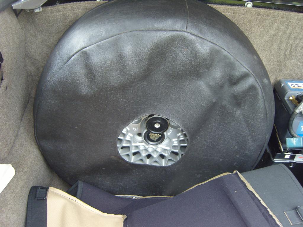

Hi Orange Blossom,
I read the opinions on the place of the better tires, and of course i have my own opinion on that.
Not to confuse you more, but I want to share my thoughts on this matter.
If safety is your concern stop worrying about where to put the tires think about what tires to put on your car. For the Goodyear Eagle is discontinued for a while, so the spares you have and the new ones still available are already aged tires. And aged tires (even unused) have their drawbacks like it can be dried out (visible and or invisible) or the bonding might be compromised due to heat, moist (fungi) and Ultra Violet radiation.
- as a tire dries out is becomes a kind of brittle and porous, a porous one will leave you with a flat tire, inconvenient but not a big deal while when brittle there is a risk of blowing (you don't want that at 100 MpH not even at 60)
- You might face a tread separation due to a compromised bonding. If you're lucky you'll see rubber flying around. Off course nobody can guarantee you that that tire won't blow, not at 100 MpH not even 60 or less)
Why will aging affect a never used tires integrity?
As the tire ages it will dry out and become more or less porous and brittle, often you see cracks sometimes you don't until using it. In this case you will start to see the cracks in a couple of miles to a few hundred miles.
UV radiation affects the intermolecular bonding of the rubber compounds and makes it less strong (dry, brittle, cracks story)
A tire is made of several layers of different rubber compounds, and other materials like steel and nylon. Due to aging the bonding between these layers can be compromised and the layers separated. (intermolecular bonding due to heat, UV radiation and fungi and the bonding between layers due to temperature differences, humidity (crimp and expansion)
A tire which ages while in use is more predictable than a tire that ages on the shelf or in the trunk as never or seldom used spare. Why? Deterioration doesn't come suddenly you will see the signs of aging coming slowly and not unexpected. You can see your tires turn grey or start seeing some cracks and of course wear.
But a "new" 0 miles tire with 8mm tread might surprise you.
Now where to put those "new" tires? I can imagine that some would put them at the front as a blowing front tire is better controllable than a rear.
But better
let it go and get 4 new tires. I know those 15 inchers are hard to find, and very expensive. But a human life is invaluable.
An alternative is maybe to size up to a 16" wheel tire combo. If you want to stay with lattice wheels they were available in 16" on later models.
16 inch is not a big visual impact, most ppl won't even notice that, and as bonus you'll get improved handling esp. cornering.
I'm not a professional so use your own common sense, My intention is to give you a mindset.

If I Change to 16 inchers, I would have thought it would make the handling worse.
As for Starters this would increase the center of gravity.
Not to mention Insurance Companies would look upon this as being a major modification!
Which in itself could invalidate my Insurance, as I have been doing some research on this and if you have a look yourself, the list of what they term as modifications is so long they could turn it into a book.
They would also give me, a false reading on my 'Speedo' and from an esthetical point of view they are not for me, although I know you are only trying to help.
Which I would add is not lost on me, So Thank You for that.
Whether or not I can bring myself to Throw this new Tyre away, is another matter altogether, so I may well keep it to use it as a Spare in case of a Puncture.
