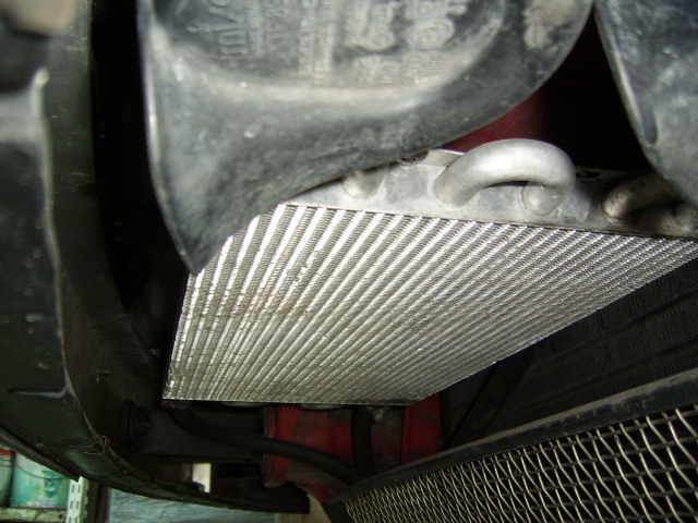

My '85 has had an external "universal" trans cooler for 14 years. It is mounted horizontally under the panel that the 2nd coil sits on.
Snap attached.
I do not run a power steer cooler on any of the V12's, removed them day 1 of ownership. The hoses are both wrapped in "header wrap" heat shielding, and I use Synthetic Trans Fluid ONLY in the steer of ALL the Jags, and it is changed every 12 months NO exceptions.

Attachment 56148
thanks definitely food for thought. i have purchased a 4 way trans one smaller than your one, i was going to mount it in front of the condenser
or between the electric fan and the water pump area as i have dispensed with the ugly cowling and mech. fan, but now undecided.
